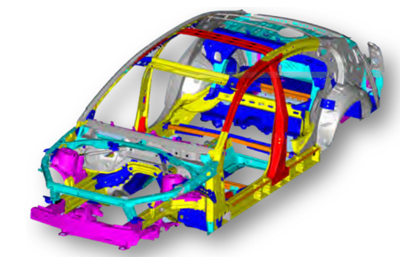

Take a look at the image below:
This is an example of variation of material in a car frame. Each color represents different steel. Some are design with high yield, some are design with high elongation / ductility.
The red color for example, is ultra high Fy so that side impact doesn't crush the driver or passengers. Purple is also high strength (65 or 70ksi, I belief), but it also has a long elongation... to provide a crumple zone for front impact.
The point being that for cars, the material properties are varied widely depending on the components.
