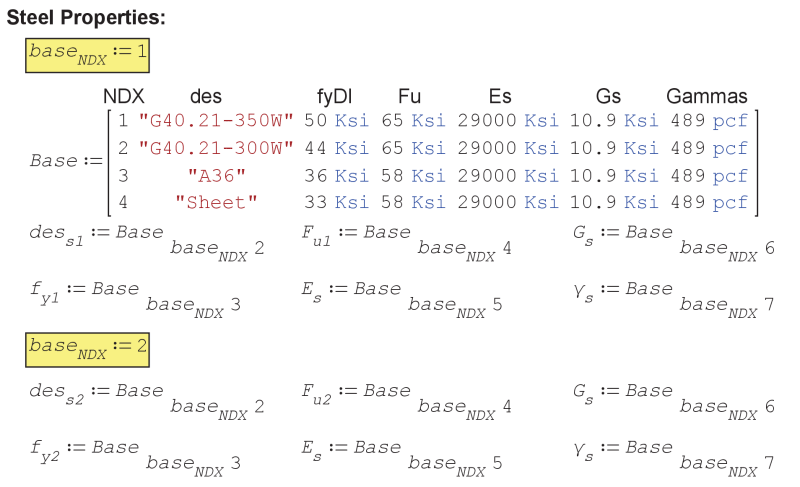

Attached SMath for Steel Properties... with SMath I generally cut & paste items to make a new program... this is my 'template' for steel properties that would be added into a new steel based program...
Dik

I tried to open a few of my old Mathcad files and none of them worked but it did bring in most of the stuff so it is a big leg up in getting them rebuilt. It also will force me to give them a top-to-bottom rethink which isn't a bad thing to do from time to time.
I looking at my old Mathcad files translated into SMath it appears that most of the errors are due to it thinking that variables are units. Is there a way to turn off units? Someone earlier asked why I didn't use units and that is why. I like to use variables as close to the ones in textbook and code equations that the units seem to mess that up.
The other errors were from the logic blocks. They did not seem to translate at all.
