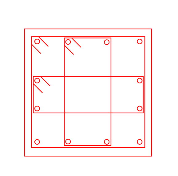

Hello all, I am aware of the need to alternate the ends of the 90/135 hooks, on this project all of the cross ties are detailed with double standard hooks of 180 degrees, and the general notes states, "Location of hooks and direction of hairpins shall be alternated in subsequent layers." This raises a few questions for me:
1. Does ACI call for such alternation on 180 degree hooks?
2. Would that alternation consist of the continuous "leg" of the tie on the opposite side of the longitudinal bar in successive tie sets?
3. How would such an alternation benefit the designed purpose of the hairpin?
I ask because as I understand the reading of the commentary in ACI 318 Chapter 25.4 Development of reinforcement.
R25.4.1.1 The development length concept is based on the attainable average bond stress over the length of development of the reinforcement.
If the "strength" of the tie is based on the bond stress of development of deformed bars, what purposed would be served by alternating from one side of a longitudinal bar to the other? It would be the only way to alternate a double 180 degree standard hook, to flip it end for end places the tie in the same position. Hopefully my explanation is properly conveyed, have you ever encountered or addressed a similar issue, any help would be greatly appreciated.

Why the closed tie design on the interior?
Idea I had in mind looked more like this, for clarity....
Why yes, I do in fact have no idea what I'm talking about
I think at minimum the 180° tie bends are "seismic" and the 90° or 135° bends would be more typical for a wind controlled design.
I kind of think all of these schemes look funky. I don't remember every vertical needing a 90 degree tie bend next to it.
That bit about flipping the ties around also feels very seismic.

I've only done a couple of RC structures in a seismic area... most of my work has been non-seismic. I've flipped the ties for all work for decades... it's standard on projects of I've designed.
If dealing with seismic, I wouldn't be messing around with 90 degree hooks at all.
