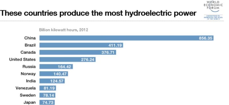

Yes, and I understand they will outlast the pyramids... The problem with aluminum, I understand, is that a lot of power is required to produce it. In future that may restrict some of the countries that produce it. Canada is fortunate in that a lot of our power is hydro, and renewable without a large carbon footprint. [pipe]

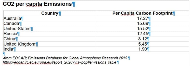

funny you say that dik ... doesn't Canada show up poorly on yourthe per capita CO2 emissions chart ?
Well aware of that Tug and have mentioned it often in the past postings. We have a bit of an excuse due to our small population, cold climate and long travel distances, as I've also noted.

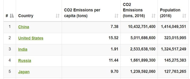

If you take a gander at the countries with over 100 million, the US leads the pack with China having about half the carbon footprint of the US. Because their population is substantially greater than the US by a factor of nearly 5, the US refuses to act on climate change stating that China is a worse offender. This is simply not true on a per capita basis. The US still leads the pack.
and more recent data, that I've, also, posted earlier. Australia's redeeming feature is the low population, like Canada's. Their climate and long travel distances pale in comparison to that of Canada: [pipe]
Yes, else our per capita footprint would be larger. See the chart... the US is way down the list. Less than Canada, a much smaller country with about 1/10 the population. China's hydro production is 3x that of the US. [pipe]

I don't see how dik can post per capita CO2 emissions and then say, lets forgive Australia and Canada, which makes the US the highest.

Sorry, I missed your comment... only a couple of things to note... If you look at the countries with populations over 100 million, the US, as usual, is #1...
Canada has a high per capita output and we should be doing better. Our high value is moderated a bit because we are amoung the top four for hydro production, else our per capita would be a lot higher. Australia doesn't have the same excuse we have other than their population. Canada's population is low, our climate is quiet cold and travel distances are quite large. These contribute to a high per capita. That's the only thing I can offer as an excuse. Our government has failed when it comes to climate change (and a few other things).
Many of the small Middle East countries have excessive per capita carbon footprints due the their small population. This differs from the US which as a huge carbon footprint and a huge population to go with it. China's carbon footprint, per capita, is about half the US. Because their total output is high (with 5x the population), like India's, they are cited as being the reason not to do anything.
