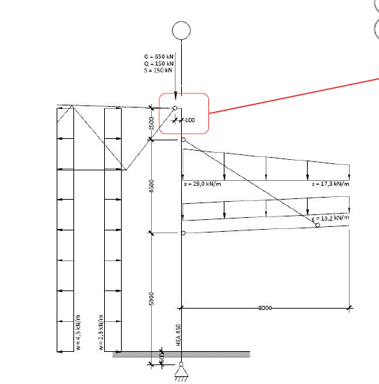

I came across an interesting structure (please see attached figure)which need to be analyzed. I am sure that it is very simple for you guys but bit confusing for me as beginner in this field.
Please support with some sample calculation.
Thanks and Regards
Nidhin

If the truss continues and was supported at the other end, you can assume the upper end of the column is supported as well, and run a calculation on a simply supported beam with all loads shown. I thing the G, Q, S indicate loads from the truss (acting on this joint) in varies case. (Gravity, Earthquake, Snow, I guess)
I don't understand those small circle though (not momently connected?).
An 8 meter cantilevered canopy is a serious structure which if not designed properly can fall and kill someone, so we must start with the statement, "Do not ask random people on the internet how to design such a structure. Hire a structural engineer."
If this is just for fun and your own edification, it should be a simple matter of statics. The small circles indicated the pinned ends of the members so there are only forces (i.e. no moments) at the connections. The canopy hanger is in tension (use the trigonometry you learned in school) and the canopy beam is primarily in compression with some flexure from the span. Apply the resultants of the tension and compression forces to the column and solve for the flexure in the column. The column design is a bit more complicated as you need to combine the axial forces from the roof with the reactions from the canopy. Other combinations will include wind and earthquake loading.

Getting the the forces and moments is all statics - sum of the moments equals zero. Solve the trusses. The linearly varying load may require looking up a formula (superposition of a uniform and triangular load is probably the easiest).
After that, it's stresses due to the forces and moments, member capacities, and safety factors. That's where the structural engineering begins, and likely beyond the scope of what can be responsibly explained on an internet forum.

This is not a cantilever structure (bottom pinned). The drawing is part of a complete design, with truss as top member. I think the OP wanted to add canopy like structure, but don't know how to handle it though. We don't need to work it out, but shall provide kind advices, if we can.

There are many things in your sketch that aren't really clear what they mean (to me at least).

Only a few notes here.
1) Assume "Q" indicates vertical component of earthquake load, where is the horizontal shear force (not on the drawing)?
2) I assume the uniform loads shown are due to wind. Where is the case that causing uplift on the canopy?
3) Upon solving the forces on hand, there should be a kick back/drag force on the truss level, how are you going to handle that without knowing the framing of the other half. Note, without a moment connection, or bracing, this structure is unstable. Once fixity is introduced, the entire picture might change.
So, please explain your project further, and provide complete information to draw on meaningful suggestions.

Retired13, Q is usual designation for imposed/service load in Europe (since HEA profile is used Im guessing its mainland europe assignement).
Klitor,
Thanks for the info. I think this is an airport hanger. But OP says nothing, I don't know.
