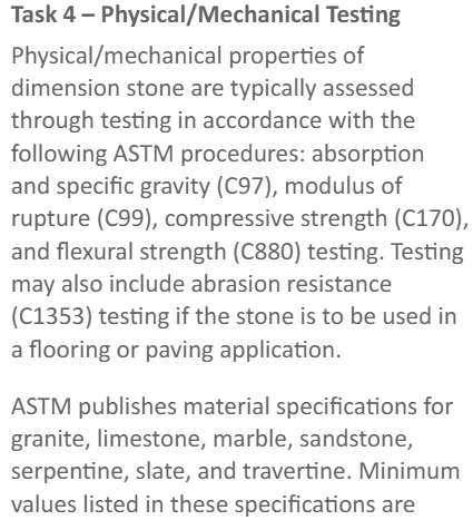

Depending on the criticality you may consider testing the rock. WJE has an article related to stone durability below is an excerpt. Bring in an expert may be a good approach.
A Google search can give you basic values. If you need specific value you can get it tested.

a) Depending on the specifications for the project / size of the job, specific testing for the project may be required. If not, the quarries should be able to provide test data. But you should require specific stone test data - way too much variance within a stone type to generalize. At a minimum, either C99 (Modulus of Rupture) or C880 (Flexural Strength) for bending, and C170 (compressive Strength).
b) Safety factors for stone can vary quite a bit, with project specifications being the first place to look. If not, ASTM C1242 lists "Generally Accepted Safety Factors for Stone Cladding by Stone Type". Good news for you is that granite is probably the best type, as it is generally stronger, and requires a lower safety factor, as the test results are more consistent than other stone types.
