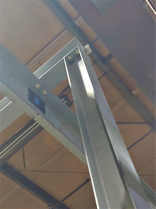

I have been assigned the task to analyze the supporting structure of a gantry crane but, being a mechanical engineer, I need to find the applicable methods to determine shear forces and moments on all elements. The supporting structure of the movable bridge beam, as I show in the picture below, is composed of two runway beams joined to three support beams, which are joined to six columns. All twelve joints are rigid, each one made with four bolts. Years ago, I calculated continuous beams using the Three Moment Theorem, but in internet I only find this method applied to beams with more than two simple supports (one of them pinned), but not three fixed supports like in this case. I don’t know how to analyze a 3D structure composed by seven rigid frames joined together, and the company where I work does not have any analysis software. My second question is, after knowing the reaction moments and shear forces at base plates of columns, I need to calculate tension forces at the anchor bolts to the floor. I will have to assume the worst concrete, 2,000 psi, as we don’t have the construction drawings of the building. Any help will be greatly appreciated. Thanks!
if your supports are fixed, then analyze each span as a double cantilever.
you can use MDM. You can use three moment equation, there are "ways" to modify the calc for fixed supports, but (IMO) each span is isolated by an infinitely stiff fixed support.
but looking at your pic, I'd say the runway beam and the support beams are continuous over pinned supports, the base of the columns are reasonably fixed.
Looks mildly sketchy to me, but if it works...
Just because there are four bolts doesn't mean the joint will be fixed - at least not as it impacts the global analysis. I'd start by assuming the base of the columns are fixed, the beam-column joints are pinned, and the connections of the crane rails to the beams are also free to rotate. The beams are likely flexible enough to bend and twist elastically which will make them behave more like pins that actual fixed supports.
What is the goal of your analysis? Is it performing poorly due to excessive deflections/drift?
I suggest pass it onto somebody familiar with structural design. The analysis is not difficult, but unless the lift capacity is small, I wonder how the framing can maintain stable when subjects to thrust both in the longitudinal, and lateral directions. Note that I don't consider the connections are fixed, they are more like pins with limited moment capacity.
Are the Support Beams installed on a slope? That would mean that the Runway beam web is not plumb which would impose a torsional force in the beam which is not a fun analysis.
Let's assume that the picture is just distorted and the support beams are level. Keep it simple, Don't analyze it as a 3-D frame. Break it apart into simpler components.
Check the shear and moment in the runway beams first. You have a 2 span continuous beam with pinned supports and a moving crane load. There are several ways to analyze this but since it sounds like you haven't solved some structural analysis problems lately, then a simple beam analysis program would be good. Without that, I do have some Manders Angers Beam equations that I can try and upload later which give you influence lines for concentrated loads at different locations.
Compare your shear and moment demands on the runway beam with the capacities that you get from AISC.
Then take your reactionary loads on your runway beam and apply it to your "rigid" frame. The fixity of the support beam to the column is questionable. You say it has four bolts, but are the column flanges welded to the bottom of the support beam flange? Looks questionable.... I would analyze the support beam using a lower bound approach as simply supported. Easy!
If you want to check your column you have your vertical load. I would probably be conservative and apply a moment at the top based on an upper bound assumption of a fixed end moment for the support beam. If that didn't work out I would refine that part of the analysis.
Check your anchor bolts for moment at the base. This will be the most difficult task and most likely will give you issues with capacity. I really don't know how you are going to analyze the anchor bolts since you don't know the embedment. The embedment is everything for this check. Since it looks like those columns were installed after the building was erected, they are most likely post-installed into a thin slab on grade foundation.
I'm surprised the runway beam isn't shimmed to make it level... and if you check the beam for PL/5... that will give you an approx idea of the bending moment. The runway beam can be strutted to the column for bracing... have to be careful about the flexural stability of the runway beam for being laterally unsupported between columns. On a positive note, your load is applied below the shear centre.
The AISC has a spreadsheet for this type of problem if memory serves.

That frame looks very unstable to me. The frames I've seen before supporting bridge cranes and monorails usually have welded beam-column connections similar to moment frames. Is there a reason why you are analyzing it? We can give some general methods to perform an analysis but knowing what the issues are (if any) might help with any assumptions we would make.

7) I am attaching a picture of a top joint. The runway beam is spliced of two sections, one is 40 feet long and the other is 14 feet long. This picture shows the middle column and the splice plate, there are two plates like that one, one on each side of the web of the runway beam.

Well, your job just became a bit easier as that runway beam is no longer continuous. It is 2 simple spans. Obviously the 40ft span will govern.
I would listen to retired13 and check the lateral loads as that whole frame seems precariously restrained as-is.

After you posted a picture of the runway beam splice on Feb. 27th, I responded by saying that your job just became easier as you do not need to analyze the runway beam as a 2-span continuous but rather 2 individual simple spans. You will be non-conservative for the maximum positive moment demands on that runway beam if you proceed with your results from the three moment theorem approach.
