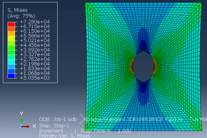

Hi Everyone,
I have modeled a plate with a center hole in Abaqus as a 3D model and used shell elements. In order to stop the top edge from bending during the load, a Pin(nodes) constraint has been applied on the top edge. I have worked in mm when I modeled this component. My dimensions have to be in mm as I am using the results for further analysis in MATLAB. You can see my setup here.
This is my Von-Mises result: (max 1.451*10^4)
I would like to validate my result using hand calculations. I have found the appropriate (I believe) equations on this website:
I have created an excel spreadsheet to calculate the maximum stress at the horizontal points of the hole:
As you can see, my results seem to be off by a factor of 4. It must be some sort of conversion error in Abaqus or in my equations.
I don't know how Abaqus calculates its results. Therefore, I don't know how to change my values in my spreadsheet to get the expected results.
Can someone take a look at my spreadsheet and explain to me how I can fix this problem?
Thank you for your help.
I would use 2D elements (plane stress) for that. It’s also important to refine the mesh sufficiently. Check this thread, it might be helpful:
Indeed, all units in Abaqus should be checked for consistency (not only dimensions but also loads and material properties).
Thanks for the tip. I have setup a 2D simulation. My results are very close but they are still out by a factor of 10 for some reason
Make sure that you compare proper stress component. You may have to create cylindrical coordinate system for postprocessing in Abaqus and transform results to this CSYS.
