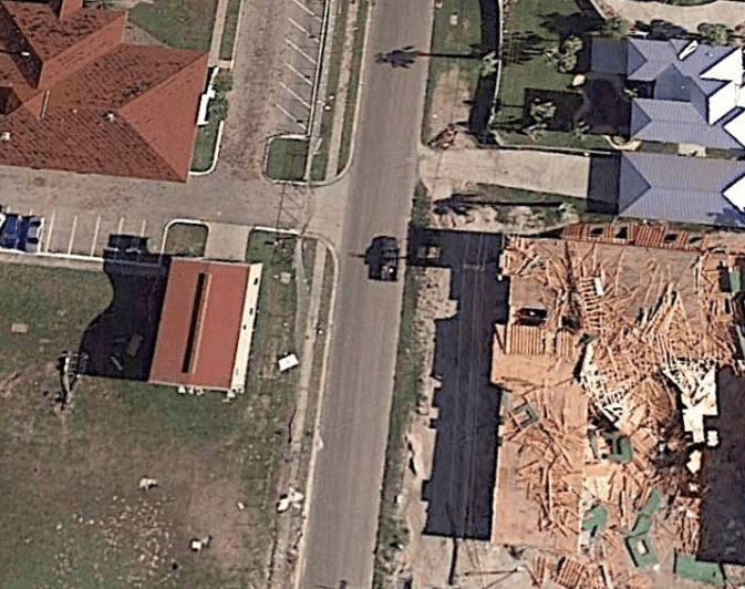

I just want to discourage anyone from using photos from a storm and pointing at one example of a building failing close to others and making conclusions about entire building systems. I attended a research symposium a few years back where a professor studied building failures after Hurricane Harvey. One of the most interesting things I learned was how much wind directionality matters and how local it is. Also how narrow the bands of the highest winds can be. This is why the professor said it's common to see buildings very close to each other in a storm where some are destroyed and some are undamaged.

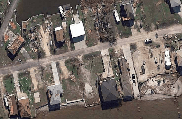

This one below is a PEMB boat storage building that held up while most of the wood structures around and the trees were destroyed. It doesn't prove that PEMBs are stronger across the board. Storms just aren't predictable like that.

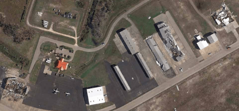

Yea, I'm not buying the professor and his localized bands theory at all. Buildings that collapse tend to have more than just one problem going on. And the problem imo is rarely that the building just happened to get hit by a wind band that none of the other buildings got hit by. Hurricanes produce gusting winds. Eventually everybody gets hit by them. And even more rare would be that ANY of those buildings were actually hit by wind pressures that were strong enough to cause them to collapse if they had been properly designed. Lets say everything has a minimum FS of 1.5. In reality it is much higher closer to 2.0. Lets say you are in a 130 mph area. Only if you get hit by the eye-wall are you likely to ever in your lifetime feel those winds. And lets say the building is hit by the eye-wall of a 130 mph storm. Well that shouldn't knock it down either cause with a 1.5 FS the building should withstand 159 mph. My point is that even if he is correct. And some buildings were being hit by higher wind pressures. I doubt the higher wind pressures exceeded the code. We've got to stop making excuses for poor design and craftsmanship.
More likely the building had a weak spot. Or the envelope got punctured and pressurized. I still see brand new buildings go up without any gabled end bracing.....duh! Most likely the buildings in those pictures had an unstable load path somewhere to begin with.

Thank you southard2. My point was simple, a presumably engineered PEMB (it's in the name, for pity's sake) is destroyed, while a presumably non engineered residence next door, remained standing. And maybe there are localized wind bands, but coincidentally they seem to be much stronger at PEMB's. Try explaining that to a jury. It's like the joke that Trailer Parks attract tornados.
And even if there was a localized wind, it knocked down the PEMB, so don't tell me failures are rare. And that wasn't the only one in Bay County.
I've been on two post hurricane assessments, Hurricane Irma and Michael. On Irma, the worst damage money wise was a PEMB where the cheap, UV damaged skylights shattered, the rain came in and destroyed the offices inside. I can't totally blame that one on the engineering of PEMB, but mostly on the details. On Michael, I wasn't expected to evaluate all buildings, just my clients'. They had very few PEMB's and the ones they had were from the 70's. That picture was just from driving around.
The other items I noticed that had regular damages were gas station canopies.
