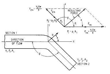

There seem to be some misconceptions here about the direction and magnitude of the thrust force the OP is dealing with.
First, the direction of the resultant thrust force is not along the pipe, but to the outside of the elbow and is oriented at mid-angle. See this free body diagram that I borrowed from EngineeringToolBox.com:
Unfortunately, they didn't draw Ry and R at the correct angles, but it's close enough for talking purposes (I will look for a better diagram). It is also important to note that for a partially to fully restrained piping system, many of the individual force vectors (which do align with the pipes) will cancel out due to equal and opposite force vectors at the previous or next elbow.
Second, while F = 2*P*A*sin(theta/2) is correct, this formula by itself is not enough. Two more things need to be considered: design pressure and safety factor.
- The OP gives a pressure of 130 psi, but is that the maximum operating pressure, the pipe pressure class, the test pressure, or the maximum transient pressure? The maximum operating pressure had better be the smallest of the four, so it's not what we design to.[smile] Depending on the client I am working with, the test pressure may be the same as the pipe pressure class or it may be up to 50 psi more. Transient pressures are usually not an issue in well-looped water distribution systems but might be an issue in a transmission main or long, non-looped plant planting. However, it's always best to deal with the transients first (e.g. surge tanks) and not let them overwhelm the thrust design. So, in general, thrust restraint should be designed for the test pressure.
- The normal safety factor for thrust restraint design is 1.5. I don't know why 1.5, but that is the standard of practice (there is a thread on this subject here: So, let's recast the thrust restraint formula like this: F[design] = SF*2*P[test]*sin(theta/2)
The best treatment I have found on the subject of thrust restraint is from the Ductile Iron Pipe Research Institute: and look for "Thrust Restraint Design for Ductile Iron Pipe" partway down the page. This document focuses on buried DIP, but the principles apply to all pipe types and to above-ground piping. The only thing this document does not cover with respect to above-ground piping is forces due to thermal expansion and contraction.

Well, the best diagrams I could find with a quick Internet search are the ones in the DIPRA document I referenced above.
This diagram is useful, if you remember that their theta is not the same theta we use in the thrust formula (we use the deflection angle of the fitting and not the subtended angle) and their alpha is half of the deflection angle assuming a constant diameter (for their change in diameter, the angle of the resultant will differ):
