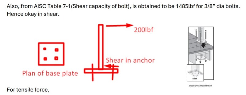

For the check of railing post top mounted on deck, is the check of shear and tensile capacity of anchor bolts sufficient?
Considering the point load of 200lbf at top of rail, the 3/8” dia. anchor bolts are checked for shear and tensile capacity induced by moment due to that point load. For the shear capacity check, AISC table 7-1 and 7-2 values are used for bolt capacity. Will these two checks be sufficient? I have carried out the calculation as such:
No. of bolts used in base plate=4
Shear load=200lbf
Shear load per bolt=200/4
Shear capacity of bolt and blocking connection is checked for double shear plane load in AWC connection calculator. The capacity is 784lbf. Hence okay.
Also, from AISC Table 7-1(Shear capacity of bolt), is obtained to be 1485lbf for 3/8” dia bolts. Hence okay in shear.
For tensile force,
Moment (M)=200*42in (Height of rail=42in)
Tensile force on pair of bolt=(M/2)/LEVER ARM BETWEEN SCREWS
This force is checked with tensile capacity of bolt from AISC table 7-2.
Attachment includes the illustration.
 https://files.engineering.com/getfile.aspx?folder=afbf3f0b-caf2-46af-a692-271947c8ccfd&file=Deck_railing.pdf
I've only given this a cursory look over but:
1) In general, it looks as though you're on the right track.
2) I feel that this is a single shear condition rather than a double shear condition.
3) I'm not sure how accurate it is to say that the lever arm is the distance between bolts. The compression side bolt won't actually see any compression. That said, the lever arm is probably pretty close to that for this situation.
4) One might take a look at the connection between the blocking and the supporting framing for uplift forces. I imagine that shear gets dragged back into the deck pseudo diaphragm.

That flatwise blocking under it is going to rip out way faster than any connection to the railing. <<< CRITICAL
3) - you need a realistic force distribution here. This method isn't accurate. Unless you are presuming the plank offers no resistance.
I was gonna say the same thing as above about the double shear plane. I don’t think that’s accurate if I’m understanding the connection detail correctly.
I would probably base the lever arm on the distance from center of bolt on tension side to center of compression bearing area at the compression side, although going bolt to bolt is probably conservative, I would guess.

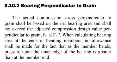

phamEng, I use a rectangular stress distribution rather than triangular for bearing area with wood. I believe that’s what NDS 3.10.2 requires. I don’t think I’ve ever seen the triangular distribution in any reference documents, although I do see the logic.
Honestly, I've never noticed that line before. Or if I did, it didn't stick. The wording..."no allowance shall be made" makes it feel like there's some benefit you can gain from assuming there is a variable distribution. What that is, I don't know. But it does specifically say 'for bending members' so that sounds like it's referring to end bearing conditions for beams and not necessarily moment connections.
The variable distribution is real, and in this case would produce a worse effect as the lever arm between a rectangular distribution is longer than the triangular. That would underestimate the bolt force in the couple.
phamEng, Yeah I’ve always found the particular wording odd. I figured the rectangular distribution is some type of approximation. Logically, it seems that the reality would be a triangular distribution, at least assuming the base plate is very rigid.
In the case of end bearing of a bending member, especially if simply supported, I would certainly expect the true distribution to be triangular in that case.
I forget if the code commentary says anything about that. I don’t currently have it handy. Perhaps has something to do with the bearing stress being considered an average.
Yeah that specifically states at ends of bending members.... That seems to be more about allowing the stress to be spread across the full length of the bearing evenly. If you did account for the rotation of the joist, you'd likely see crushing on the front edge of the plate. Keep in mind plate crushing isn't quite failure. It just deflects down a bit and it's not even linear at 100% of the allowable. (More treatment of that in the Woodworks material by Thompson)

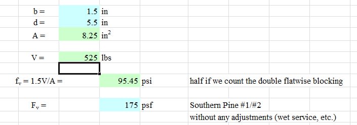

The connection between the double blocking and the joist/rim board should be doable. I get a shear force at the ends of the blocking of roughly 42" x 200 lb / 16" = 525 lb, which is based on the joist and rim board being spaced at 16". This force can be resisted with half a dozen or so nails/wood screws. This also doesn't account for the extra resistance from the deck boards.

When it comes to this particular design, that shear load through the flatwise blocking doesn't look viable to me, end nails into the blocking, for one, the shear in the blocking, and the connection hardware. The depth is 1.5" for fv = 1.5V/A. There isn't any support under it so you can't reduce the check to d from the face, and in the simplified sense, that's a square shear diagram due to what is pretty much a point moment. Maybe it works on the math, depending on how much wet service you want to throw at it, and the connections also have that wet service to contend with. I don't see a mechanical connection (screws, nails) between the flatwise blocking and the joist that's going to take that force. I didn't like the shear in the blocking but that's maybe workable.
Just presuming the 525 lbs is correct...
I don't love this connection, although, by the book it should work. I ran some rough numbers which did account for a wet surface factor of CM=0.7 and an end grain factor of Ceg=0.67. Using a load duration factor of CD=1.6 somewhat offsets these deductions. I also am aware that using CD=1.6 is debatable. Still, using CD=1.0 instead would, I think, still result in a connection working, just with more nails/screws. It's a good point concerning the long-term condition of this connection after the wood has dried out. Perhaps something live a (galv.) metal connector angle would be better. Wood screws into the deck boards with decent pullout capacity should also help matters.
