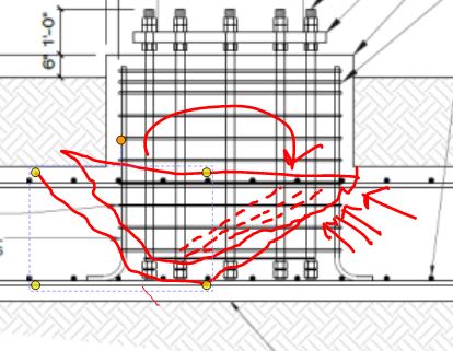

Looking for some input on design/evaluation of the situation below. Existing structure that my company owns which was engineered and recently built by others. I'm evaluating some changes to the loading. Foundation for a telecom tower with large (2400 ft-kips factored) overturning moments and fairly low (30 kips) axial loads. Anchor bolts are 18J bars that are threaded each end. While deformed, they're nowhere near enough embed to be developed in tension.
The pedestal was designed flexurally and the anchor bolt embed was evaluated to develop the pedestal reinforcing above the concrete breakout failure plane. This is how I typically see it for drilled pier foundations and it appears they applied the same logic here.
My issue is that the reinforcing is not developed below the anchor bolt concrete breakout failure plane. So I got into checking the concrete breakout strength in tension and my approach is leading to failure.
I analyzed the bolts about the Y axis in the pattern sketch below. So there are 4 bolts in tension, 2 on the neutral axis and 4 in compression (no grout). The axial loads skew towards compression by a few kips. Total tension in those 4 bolts was approximately 700 kips. With an heff of ~26" (using the 3' deep footing only), Anc for my odd 4 bolt pattern (shape is below) was 9573 and I get an phi-Ncbg of around 247 kips (way off).
So I guess my questions are these:
1. Should I have completely neglected the pedestal vertical reinforcing in my tension capacity? Can it assist at all?
2. My failure plane passes thru the pedestal which was cast integrally with the foundation. On that side it would pass thru reinforcing that is developed below. Any reasonable manner to consider that reinforcing?
3. Is it appropriate that I've completely neglected the anchor bolt deformations?
4. I did not consider the template embedded in the concrete to add to the Anc as it was only 1/4" thick. Too conservative? That would also increase my heff by a couple inches.
5. Any flaws in my general approach to this evaluation?

My thought was that the breakout failure plane on the pedestal side (left side of the black snapshot in OP) would continue vertically into the pedestal and either engage the pedestal verts on that side or increase my effective embed. Grasping at straws with this one and certainly wouldn't account for the difference.

I think the only vertical bars that can be credited as anchor reinforcement are those which cross the assumed breakout plane of those 4 tension anchors. The moment resistance of the pier itself is based on a full plane section, with stress distribution based on elastic theory. But the breakout resistance of the anchors is based on an assumed pyramid-ish chunk of concrete trying to pop out and only being held together by whatever rebar is crossing that crack plane.
ACI 318 only considers reinforcement to be effective within 0.5hef of the anchor, but that doesn't really come into play with such a deep embedment in this case. So just be consistent with your assumed failure plane that you sketched out in your first post. Overlay that with the vertical rebar pattern and however many bars fall within the perimeter could be counted as anchor reinforcement. Bars outside that perimeter might be part of the pier's overall flexural resistance, but I don't see how they can be holding that anchor breakout plane together if they don't cross it.
I almost think this design would have been better off with anchors 2 ft shorter so the #10's had a chance to develop on the hooked end. But maybe that was the anchor length they keep in stock and they could't make the foundation deeper due to the shallow bedrock.

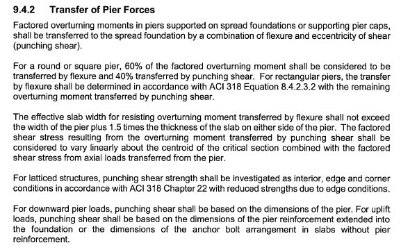

Below is a snip of a section from the TIA tower code which governs the design of this tower. It appears they allow the breakout to be neglected if the anchors are connected to a plate 'developed with foundation reinforcement.' This would be why the standard check in this industry seems to be the development of reinforcement. Again, unfortunately, in this case it is not developed below.
I also checked the anchor pullout neglecting the embed plate and it was 57% over-stressed. If I wanted to use some of that 1/4" plate, would it be possible? Thickness of the plate(?) - that's what 17.4.2.8 allows? Or is that far enough away from the bearing surface of the nut above that it's a no go? A calc using bearing of 8*f'c as a pressure yielded a length of only .187" before reaching the plastic moment. Hard to say the 1/4" plate would be effective at all. I also read the Grilli & Kanviinde report and the plates they used were >2x thicker than the anchors. I'm digging thru some old designs now and I'm not finding where anyone checks the anchor pullout. And I don't see how it works with these thin plates.
Sounds like the code give a choice between developing the anchors with vertical rebar OR checking punching shear of the anchor group. Maybe they went with the punching shear option. I’ve never heard of that being allowed as an alternative to the Chapter 17 requirements. Not even sure how you calculate that and why it would absolve the breakout failure mode.

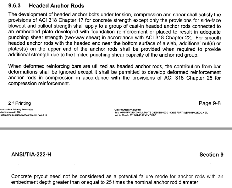

Here's another section from the tower code.
In my reading the last couple of days, there's an argument that anchorage force is similar in mechanism to punching shear. But it's not similar in calculation with anchorage being more conservative. . The Grilli & Kanvinde report discusses this a bit along with a third method.
Checking the footing for punching shear from the pier forces is a standard part of footing design. But the forces first have to transfer from the anchors into the pier, and that load transfer path seems to be deficient due to the lack of breakout capacity or properly developed anchor reinforcement. Even if the numbers work for punching shear, the anchors will fail in breakout before the punching shear failure can occur. It seems like they probably checked the anchor steel capacity and checked the pier capacity, but overlooked the transfer of load from the anchors to the pier.
There is an inherent difference in capacities between punching shear and anchorage. There have been some discussions on this forum before. My brief summary:
1) Anchorage calculations are based on un-reinforced concrete. By this I mean the testing that was done that forms the basis of the anchorage formulas was all done on un-reinforced concrete.
2) Punching shear calculations are based on reinforced concrete. Any testing that was done was based on reinforced concrete.
3) The anchorage calculations, in my opinion, are likely overly conservative.
