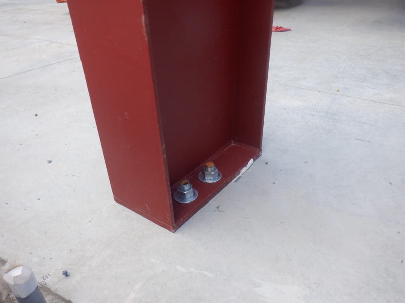

I dropped by the project site briefly today as they were taking a break from erecting the first few frames.
Looks like they used all-thread rods and cut to length. 4 anchor rods per column base. Looked about 1" diameter. No provision for any grouting under the base plates

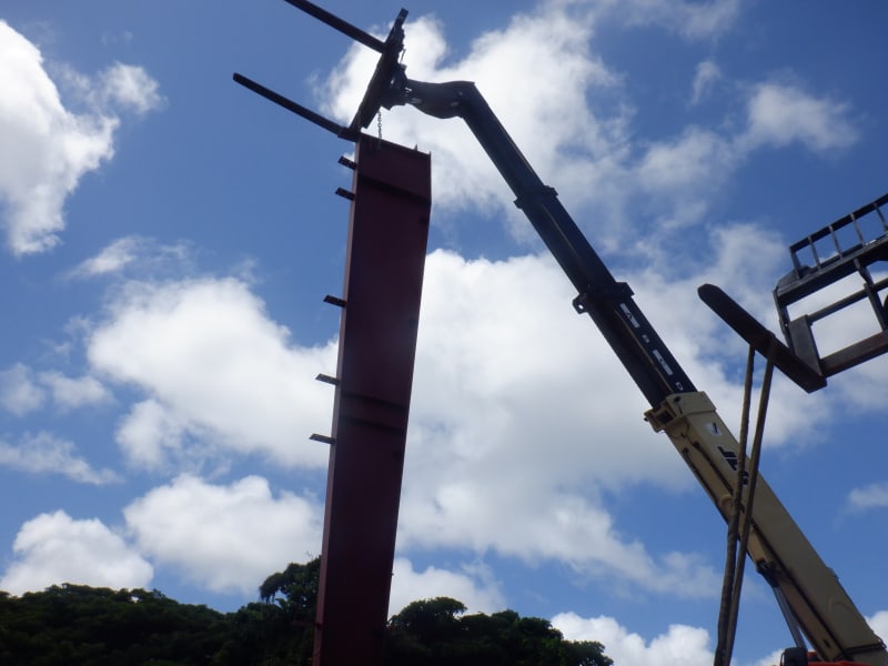

I was not there when they were actually erecting the frames, and there was NO CRANE to be seen, just 2 each sky tracks and 2 each boom lifts.
The first two frames were fully installed with the transverse moment end frames (between the main frames) installed before I arrived at site.

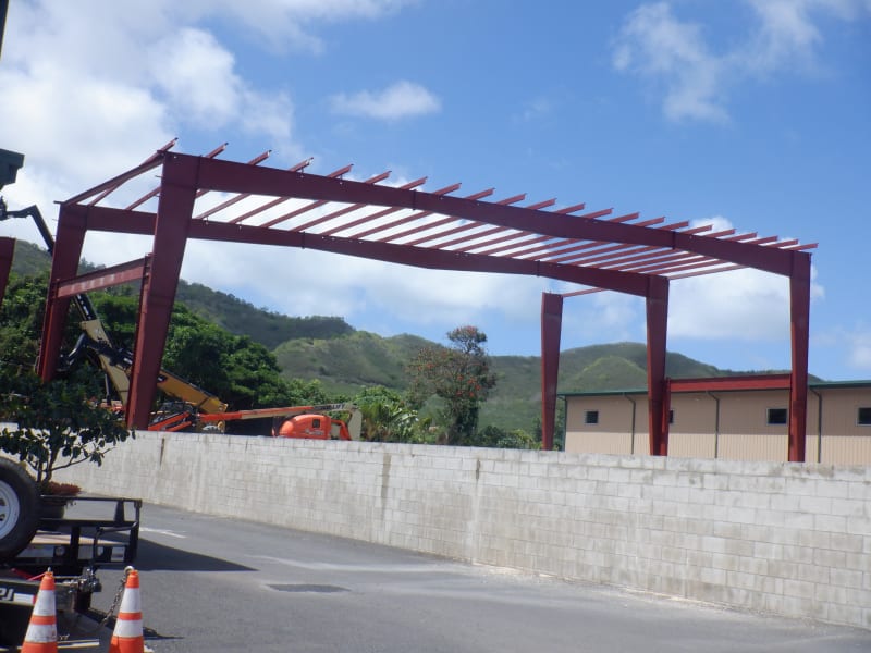

Looks like they are doing the following for the remaining frames:
1. setout/markout the column base plate C/L or perimeter on the top of concrete slab, and possibly drill the 4 each anchor hole and install anchor rods.
2. using skytrack, lift 1 x column section into place and secure to anchor rods.
3. install the next adjacent bay column section into place and secure.
4. install eave strut between the 2 column sections installed.
5. repeat for the other side.
6. skytrack (double skytrack pick?) the frame rafter into place and connect to the previously installed column sections.
7. install purlins.
8. rinse and repeat​
I think it was the same crew that did the concrete work of several weeks ago, so the developer appears to be self performing all the work.
Oh dear. That spacing is waaaaaaay too close for any post installed anchors. To get a hole large enough to clean and then correctly apply the adhesive/epoxy anchor...you'd have about a 3/4"-" of concrete left between the anchors!
For really small MBS structures I could see it - but most of mine are a) too large to begin with and b) have too much reinforcing in the vicinity of the anchor bolts (2" edge distance - really guys?) to allow drilling and post installing. The GC usually needs very accurate templates with marked centers and a surveyor to locate the templates prior to pouring.
At least this one appears to have bypass girts, so edge distance is not quite as big of an issue.. I agree that the anchor spacing appears like it might be too close for most published epoxy anchor capacities.

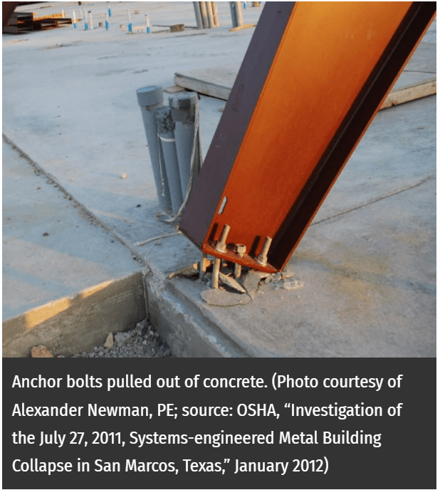

Nothing to see here folks. I had a photo of a PEMB anchor failure due to a tornado but can not find it at the moment.

That failure was caused by erection issues. Most PEMBs dont develop a moment at the frame support. The moment created, may have failed any number of anchor rods. Small PEMBs use 5/8" anchor rods, too.
