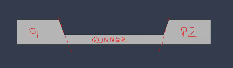

I have a project that could potentially require a custom de-gating setup (for injection molded parts), and was hoping to pick your brains on potential solutions.
I need to cut a fairly large gate (let's say 0.4x0.4" for discussion) that's located adjacent to critical optical features. For similar programs in the past, we have utilized both laser de-gating and automated saw cuts. Unfortunately the material is PC, so laser is a no-go. Additionally, the gates are angled 10° off vertical, which complicates the saw-cut solution. Our previous saw-cuts had vertically orientated gates, which was a simple enough design with a single shaft and motor.
My preference is to stick with saw-cut with this program, but I'm struggling to come up with a good solution for power transfer to the angled shafts in this configuration. First thought is to just use CV joints, but I'm not sure if there's a better/simpler solution out there. Any and all suggestions are welcome; again, this is just in the early brain-storming stages. Ideally I'd like to stick with off-the-shelf solutions.
