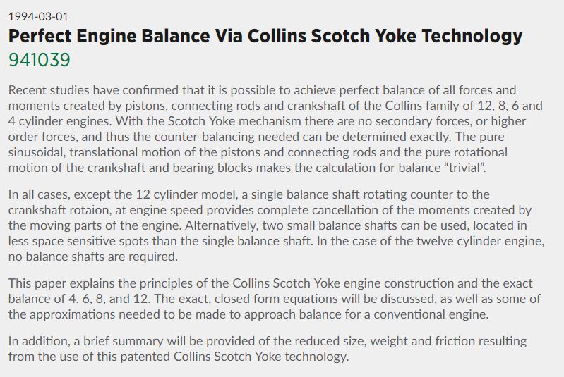

There's a pretty thorough examination of Scotch Yoke lubrication at . The conclusion is soft IMHO
This SAE paper is also interesting, though I'm not willing to spend the bucks to get a copy from SAE...
It's an indictment of the patent system, IMHO, that a patent was awarded in 2019 for a design approach that's been discussed in open literature for a long time.
