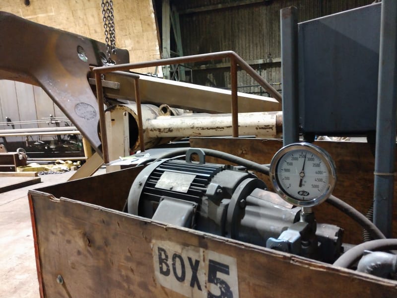

I have a test fixture that uses a pressure regulator that has a hand knob so I can adjust the pressure when performing load tests.
In my case the area of the cylinders is known and we calculate the force based on the pressure.
Some thing you could add is a ball valve you can close and pre-set the pressure you want.
My set up is hard on the valve and creates a lot of heat, but I don't care because it is a short duration.
