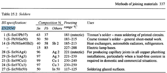

I’m trying to find details about a solder referenced in British Standard EN29543. The only reference I could find online was from page 337 of Materials for Engineers and Technicians by R. A. Higgins.
This list (see below) is incomplete, and I was trying to find information on the composition of EN29543-18. Could anyone provide me this information or direct me to a source?
Thank you and best regards,
