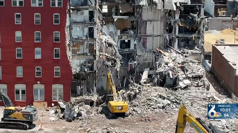

Demolition started:
It looks like they're struggling to contain the process, encroaching on neighbouring structures, lower right.

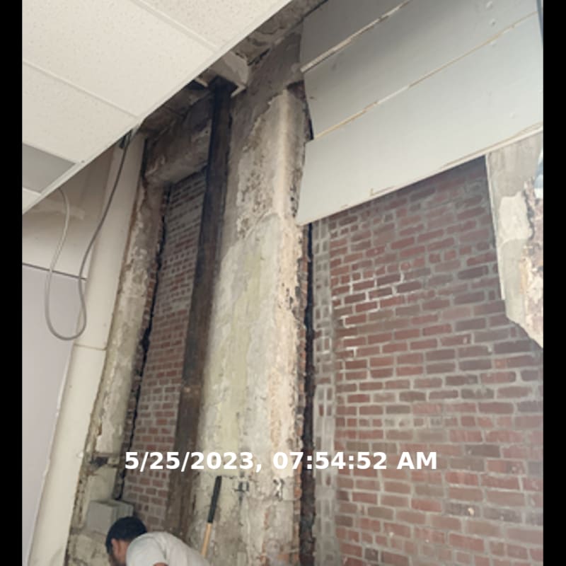

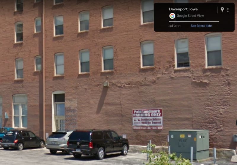

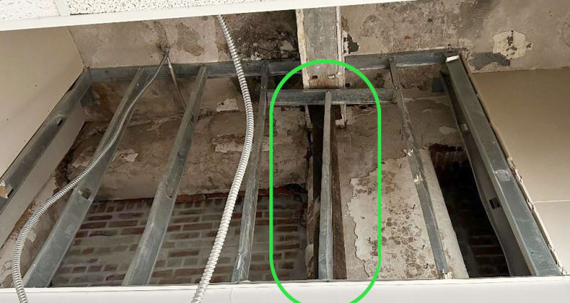

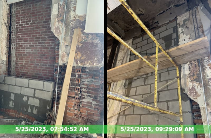

From an inspection report by Select Structural (May 23/24), a clue as to why this structure failed in stages, ... the piecemeal approach to rehabilitation. A shore post can be seen behind the interior finish, obviously an earlier reinforcement, perhaps dating as far back as 2011.
Select Structural
Google Maps

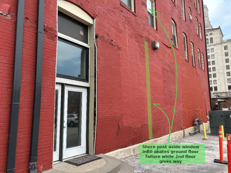

Random interventions cause disconcerting external symptoms alternately between the ground floor and second floor, though the bearing capacity has in fact failed throughout.
Select Structural

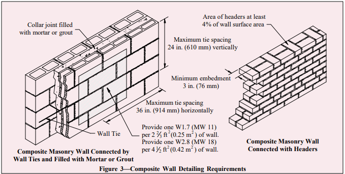

Relevant to the discussion, from NCMA (this structure has five wythes whereas the article only references two):
National Concrete Masonry Association said:
- Composite walls are multiwythe walls where both wythes act structurally as one unit. They depend on sufficient stress transfer across the joint between wythes for composite action.
- To ensure shear transfer, Building Code Requirements for Masonry Structures requires that the joint between wythes ... be crossed by connecting masonry headers.
- Although allowed, the use of masonry headers is an outdated method of connecting masonry wythes and is not recommended for several reasons. Headers are less ductile than metal wall ties, making accommodation for differential movement a critical issue. Differential movement can shear the headers, effectively eliminating the composite action, particularly with the combination of concrete masonry and clay masonry wythes. Also, walls bonded by headers are also more susceptible to water penetration.

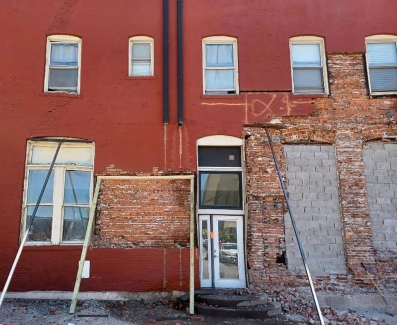

The west masonry wall was e.o.l., being so fractured as to not carry a load throughout its cross-section as intended. The elevated floors/structural frame only rested on the innermost wythes while decay attacked the structure from inside and out. Structural support is only derived from the masonry between window stacks and the lower most floor is least capable as commercial light demands greater prominence and impinges on this space. Infilled windows are not necessarily adequate structural enhancements.
Although Select Sturctural called for additional shoring in four foot increments during earlier winter repairs, there is no evidence that the owner provided same during May repairs (May 25).
City of Davenport
Meanwhile the horrific state of decay revealed itself as the external detached wythe/veneers fell away ... a few days later!

It looks like that building should have been a demo project 20 some years ago.
That doesn't look like a shore post - just the studs to cover the old opening. It appears not to touch the beam above.
This shore post, behind the steel stud and still there two days later.
City of Davenport
Edit: The timestamp is a little suspicious as the photographer would have been very busy at 7:54:52. Not even Santa Claus could accomplish so many photos at once.
