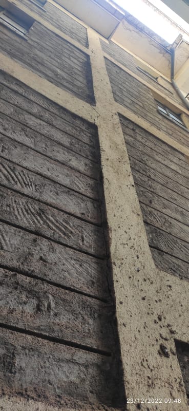

Did a recon visit to a building I've been asked to give an opinion on for the cause of cracking and recommend remedial measures.
Photos and a preliminary structural layout are attached. The building has ground + 3 suspended levels then a pitched roof, gravity load path is through load bearing natural stone masonry walls with some 250x250mm columns as shown. Foundations for the walls are strip foundations. Slabs are 150mm thick with 450x200mm beams.
Along gridline C there is a level change on the floor slab as indicated on the layout with a staircase and on the photos you can see different floor slab beam levels.
The crack also runs along this gridline, its visible on the exterior and interior wall surfaces, runs also on the floor slabs.
An attached sketch also shows how the land around this building is like, there is a slope on two sides of the property captured with the orange pen. one photo captures the slope as well.
I intend to bring on board a geo-tech engineer as I think the slope and the less than one year old neighboring building may have an effect. I also intend to do some reinforcement scans on the floor and beams at the crack location just to see how the step was implemented. Finally open an area to look at the size strip footings.
In your enlightened opinion, what else should I investigate
Though I have to admit the nature of the crack is giving me pause, wondering whether I'd like to be involved in this!

There is no dry wall, the wall os plastered and painted on the interior and key finish for masonry mortar joints on the exterior.
Yes, the cracks go thru beams and floor slab as seen on the third photo, the exterior wall photo
Building is 14 years old, cracking has occured within the last one year.
The second picture of the first post ...My gut feeling is , the spreading and creep of the foundation soil at slope side..
My suggestion would be , lifting the settled ftgs to original level , underpinning of the foundation , improving the surface drainage conditions .. But work with an experienced GEOTECH group..

Since the crack(s) have apparently occurred along a line where there is a sort of discontinuity in the structure (i.e., a vertical step in the elevation of the foundation and each floor slab/frame), my gut instinct would be that the cracking might likely be the result of something inherent to the original structural design or construction, because stress concentrations or risers are naturally likely to occur at such discontinuities. It could also be related to foundation settlement of course. Construction of the newer adjacent building could also have an influence, but my initial opinion would be that that would not be the most likely scenario. It sounds like you may have some money/fee to put toward this investigation. If so, and I thought settlement might be an issue, I think I would start by recommending some sort of elevation survey/mapping of each floor of the building to try to identify whether and how much movement might have occurred, and if there is a discernable pattern to any such movement.
YuleMsee:
I would check with a GeoTech guy about the prospect of slope stability and if the sum (weight) of the two bldgs. brought this on. That is a pretty steep slope and it is very close to the bldgs. However, the vert. cracks which can be seen in your photos do not really show much relative vert. movement btwn. the two sides of the cracks; nor do they seem to show much width variation from top to bottom. I would want to monitor these cracks over time. Put some marks or gages on the cracks to monitor their movement. It also appears that there is an intended elev. change in the floor framing system at grid C. This can be seen in the ext. conc. beam elevs. on the ext. photo, your third photo, looking up the ext. wall, btwn. the two large balconies. What do the structural framing details look like in this area, on this grid line, and how could they be influencing the cracking? Is there paint or dust and crud in the cracks which would indicate that they have been there for a long time? Do similar cracks show up all along grid C? Really study these cracks for variations and changes at various details and locations and take many more photos, identified by floor and location and detail and shown on you plan, to start to hone in on any similarities and differences and what might be causing the problem.

I agree, we will propose reinforcement scans to see how construction was implemented at that point.
A movement survey would greatly help, thanks for pointing that out

I have to investigate how the framing was done, will use reinforcement scanner.
Yes, the crack shows on the walls on gridline 1, goes thru the slab as shown on the layout and then appears again on the walls of gridline 3, its as if its forcing a movement joint on gridline C
I will have to study the cracks more keenly when and if the real work starts
