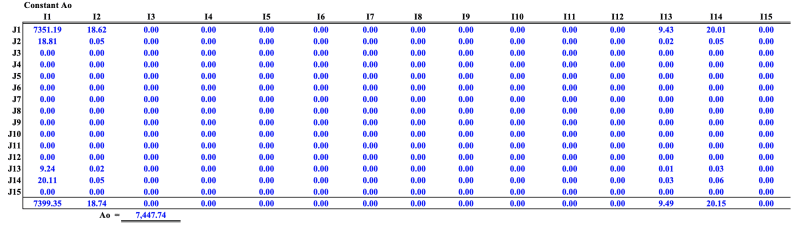

I'm currently applying the Lee-Kesler EoS to calculate enthalpy departure but I have run into problems applying the mixing rules mostly because different approaches are used in literature.
All the other formulas (Zci, vci and w and Pc) are straightforward except the critical molar volume (Vc) and critical temperature (Tc).
I'm having challenges simplifying this formula for a single has natural gas composition. How do I simplify the equations for a natural gas stream with no liquid phase. I will be glad if anyone with experience with applying the Lee-Kesler EoS mixing rules can shed some light on this.
I have attached screenshots of the mixing rules from theAll the other formulas are straightforward.

no simplification of the equations, just follow the math rules.
xi - mole fraction of the ith component
xj - mole fraction of the jth component
Vcj - critical molar volume of the jth component
Vci - critical molar volume of the ith component
Tci - critical temperature of the ith component
Tcj - critical temperature of the jth component
so, the gas composition is known, so are xi and xj.
- Vc and Tc for each component are known
- if you write code, best done using loops for n-components, where n is the number of components in gas composition.
- if using excel, can write formula in rows (down) and columns (across).
see the attached image file for an example using 4 components of a gas composition.
hope this helps and good luck.

Just so we can put this matter to rest please find some time to go through the attached excel file.
It is an attempt to calculate the molar volume Vc for a hypothetical three-component mixture of methane, ethane and propane using the LK EoS mixing rule.
I have taken the critical properties from ASPEN HYSYS.
Once it is okayed, I will write a MatLab code for the calculations.
Please let me know if I pulled it off as advised. Thank you.

I can't thank you enough for all your help.
I really appreciate it. Realized I was executing the math wrongly in excel.
I have since corrected it and the result is the same as yours.
Thank you so once again.
