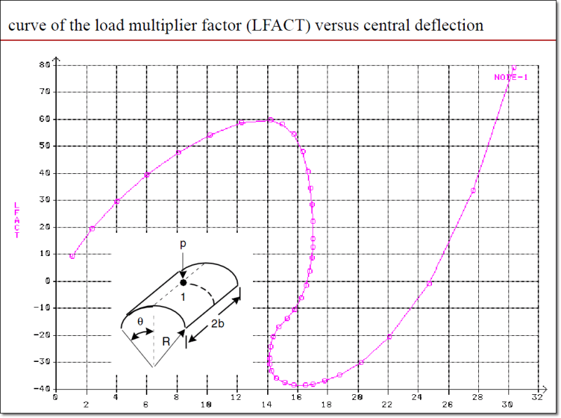

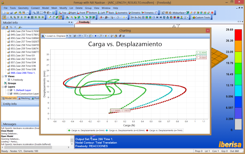

In nonlinear analysis in problems controlled by load or enforced displacement when the solver do not converge one reason could be that increasing load or displacement is not possible because the finite element model experience a negative load (buckling) or negative displacement (snap-back, snap-through), in this case the only solution to get the nonlinear problem converged is using ARC-LENGTH control, the Modified Riks is my preferred method.
