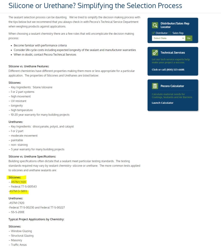

I just found this document which appears to show that either ASTM D5893 or ASTM C920 is acceptable to obtain a quality joint sealant:

ASTM C920 is a testing specification for "Elastomeric Joint Sealants". A manufacturer provided reference is linked for information. Otherwise, it cost you $44 to obtain a copy from ASTM. Link
Based on the information provided in the Link, it appears that ASTM C920 would be appropriate to be called out on the detail. I say this because of the following in the link attachment:
ASTM C 920 is the Standard Specification for Elastomeric Joint Sealants that are cured single or multi-component, cold applied elastomeric sealants.
Is this what you are trying to imply?
I would agree that it seems C920 is more appropriate choice, unless your application is highway/runway pavement related, which was indicated in the title of the D5893 specification, and in the abstract provided.
