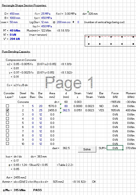

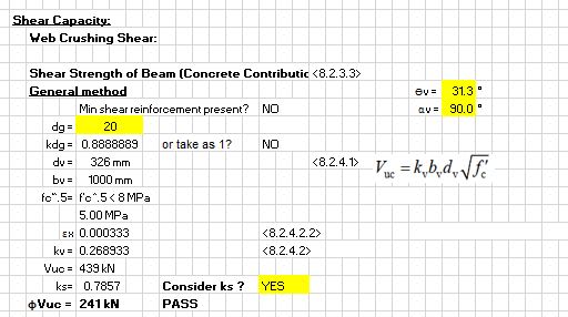

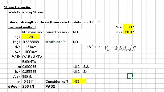

Images attached. Just playing with the Ks value, there seems to be a sweet spot around 450mm where increasing the thickness gives diminishing returns and actually lowers the capacity at the 600 thickness mark. It's annoying as sometimes its more economical to design a thicker foundation and use concrete capacity in lieu of shear reinforcement.

If I set the compression steel to zero I agree with the flexural capacity exactly, but I get 5-10% lower Vuc, resulting in the ks.phi.Vuc value for 600 thick being slightly higher than 450 thick.
I will have a closer look to see where the difference is coming from, but the exact numbers are not that important, we agree that increasing the depth from 450 to 600 mm only has a very small influence on the maximum shear allowable without shear reinforcement.
I don't see that as being a problem. In the 2009 code there was a 50% reduction in the value at 300 mm depth, and this has been changed to a transition from no reduction to 50% between 300 and 650 mm, so in effect an additional reduction factor is applied over a range of depths, rather than as a step reduction at 300 mm depth.

I have found the difference between our calculations.
Cl. 8.2.4.2.2 says that M* shall not be taken less than V*dv (if no prestress), so for low applied moment and zero axial load and prestress, M*/dv = V* and
strain = V*/Es.Ast = 204000/(200000*2454) = 4.16E-4.
So for this case the strain is the same for both depths, and considerably greater than that found using the input M* value.
Doug Jenkins
