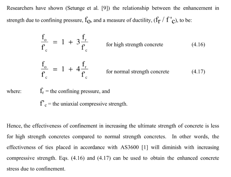

Secondly, Note 1 at the end of this clause states that confining reinforcement may be used to increase the effective strength of the concrete, and the commentary suggests doing the same. What sort of methods/resources would you use to calculate the increase in effective strength for a certain amount of confinement provided? Calculating a confinement pressure is simple enough given the equations given in Clause 10.7.3, but I am unfamiliar with how one would determine what increase in effective strength arises from this confinement.

Second point is a good question. People have asked me that question a few times about how to increase the effective compressive strength of the concrete using confining reinforcement and I don't know. There is nowhere in the code where the compressive strength goes above f'c except for section 10.8 and that clause about bearing surfaces which I don't really like. As far as I know there is not really a precedent for it.
There eurocode will allow an increase (~10%) in compressive strength when confinement is provided.

Trenno - are you referring to Clause 3.1.9 in EN1992-1-1? It seems that clause gives about 5% increase in concrete strength for every 1% (of f'c) in confinement pressure, which to me and the projects I work on seems pretty low compared to the equations in AS3600 10.8, unless we are meant to be considering the effect of the confinement on top of the calculated f'ce values from 10.8.

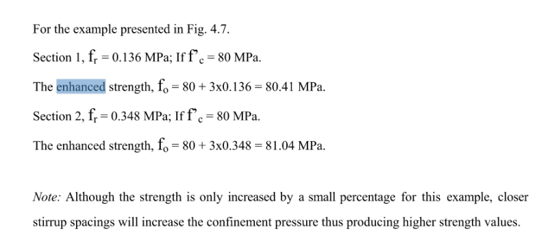

Priyan Mendis' book, "Design of High-strength Concrete Members", Section 4.4 "Laterally confined concrete columns-calculation of confinement pressures" includes the equation & example below.
