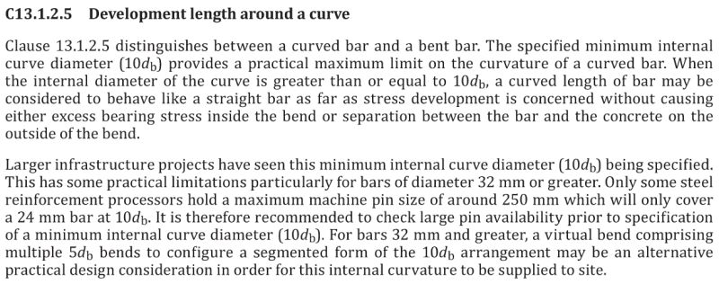

Can someone shed some light on clause 13.1.2.5 Development length around a curve?
Does this apply to horizontal bars at the corner of shear walls? Section 14 shows the bend for boundary element discontinuity only.
How does this match up with the closed fitments?
Which other standards require this?
Snapshot from that section of the commentary for you, if that helps.

Clause 13.1.2.5 seems intended for a different scenario where for whatever reason you need 100% development at a certain location rather than starting with the 50% from a standard cog. With a curve diameter of 10db or greater, you can take your development length as though it were a straight bar.

The around a curve stuff is I think more for say a situation where a bar going into the face of a wall where you cannot achieve a full development length for a 90 degree hook (say wall isn't thick enough to achieve this), if you limit the bend diameter you don't crush the concrete so much and code implies you can use an equivalent length to a straight development length continuing around the curve. British standards also allow this for development (in NZ its not allowed).
