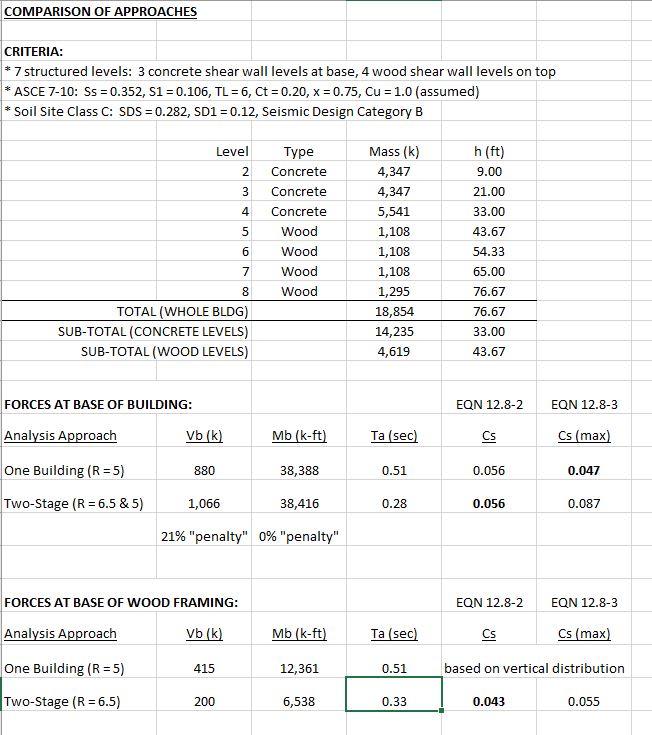

When looking at the ASCE 7 Two Stage Analysis Procedure, there seems to be an anomaly that bothers me and I'm wondering others opinions/experience. In terms of seismic forces, it seems to me that the two stage procedure can be quite beneficial for the upper level light-framing, but can be penalizing on the lower rigid structure (and foundations).
What bothers me is that I could look at it per 12.2.3.1 (ASCE 7-10) for Vertical Combinations and potentially get an overall lower base shear/overturning on the building, but a higher distribution of forces on the upper levels. Or, I could look at it per 12.2.3.2 as a two-stage and get lower distribution of forces on the upper, but larger overall base shear and overturning for the building.
What I would really want to do is design the lower portion per 12.2.3.1 and the upper per 12.2.3.2. It seems pretty clear that is not the intent of the language of the code, but the practical side of me says that if I took the penalty on the upper framing by just using 12.2.3.1, I have a code-complaint lower portion of the structure with lower design forces. But if I design the upper per 12.2.3.2, all of a sudden that same dsign for the lower portion is not code compliant? How does the lower portion know what design methodology I used or what forces the upper levels were designed for?
In my particular current case, I'm looking at a building that is 4 stories of wood framing over 3 stories of P.T. slabs and concrete shear walls, so perhaps this anomaly is more severe than a single level rigid lower portion.
Am I way off on this type of practical thinking? Even if I am not, perhaps I am just yelling at the clouds.

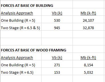

Mike -- this is what my last table was supposed to look like:

Mr. Downey, seems a bit odd to me your base shear for your entire structure differs by almost a factor of 2 between the two methods. Can you share some more of your variables? Which ASCE 7 formula determines your seismic response coefficient? I suppose your results might make sense to me if the limitation of ASCE 7-10 12.8-3 controls: Cs = (SD1 x Ie) / (T x R)
Mike, yes I will review and share more detailed results. This particular project has been stalled in the early stages for a while now, but may start heating up again, so a good chance to double-check my quick early numbers. And now it's turned into a podium with three separate buildings on top, so while it's pretty clear to me that the two-stage approach is the right approach, even with a "penalty" on the podium, I always want to understand what drives the results. Stay tuned.
Chris
Mike, I will say a few things after taking a closer look at my numbers:
I was incorrectly using Test = Cu*Ta to determine my forces. We do a lot of steel moment frame parking structures, so this is how I generally start my analysis and then verify that the actual period is greater. I'm usually smart enough to make Cu = 1.0 in my spreadsheet when doing stiff shear walls, but was going too quickly.
You are correct that whether or not Cs (Eqn 12.8-2) or Cs-max (Eqn 12.8-3) is controlling can make a significant difference, and obviously is dependent on height and period:

My incorrect use of Test had Cs-max controlling for both methods.​
[/li]
[li]
Using Ta with my condition of 3 concrete levels below 4 wood levels had Cs controlling for the Two-Stage procedure and Cs-max controlling for the Single-Building approach.​
[/li]
[li]
For curiosity's sake, reducing my number of concrete levels to 1 level makes Cs control for both methods.​
[/li]
[/ul]
In the end, for my case, I'm no longer finding much of a "penalty" on the concrete levels with the Two-Stage method. A 20% increase in total base shear, but virtually no increase in overturning. And when looking at just 1 level of concrete, I'm seeing only an 11% increase in base shear, but a 36% REDUCTION in overturning. So, maybe I was wrong all along (don't tell my wife I admitted I was wrong).
Now what I'm starting to wonder is if I really should verify that the 3 concrete levels meet the 1.1 period and 10x stiffness requirements for the Two-Stage procedure. This is what brought you this thread in the first place. You have 2 levels of concrete moment frames and I have 3 levels of concrete shear walls, both below 4 levels of wood. My gut tells me your lower levels will be too flexible and I'm hoping (and was assuming) the opposite for me. I will use RAM Structural System to analyze the the concrete levels so that I can export to their post-tension module, but I still think I would do the stiffness and period checks by hand. The problem for me is that I am not designing the wood levels, and both the concrete and wood levels are at a schematic level right now.
Thanks for making me take a closer look.

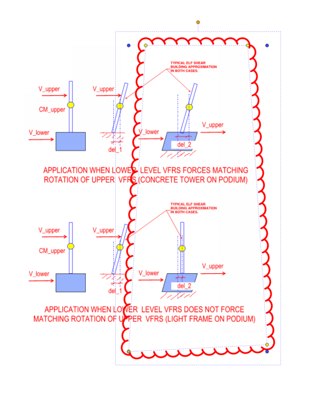

Koot K., I agree with the first half of your post, not sure I follow the second half. What is del?
What is del??? I posted explicit pictures of del FFS.
del_1 = the center of mass drift of the upper portion of the building relative to it's own base.
del_2 = the center of mass drift of the upper portion of the building relative to the podium's base.

It seems to me rotation plays a bigger role on buildings with small footprints and shorter shear wall lengths.
I wasn't speaking to the absolute rotation of any one system versus another but, rather, whether or not the nature of the setup encourages consistent angular rotation between the upper and lower portions of the building. It's the difference between the two, clouded sketches below fundamentally. Were you to shear the base over to one side, does the upper building do that too or just go along for the ride rigid body like?

I got you now, if upper portion rotates along with forced rotation in lower portion, it's not a good candidate for 2-stage procedure. Is your thought that because the modal response of the two are tied together, it's unconservative to analyze the upper portion as though it sits on a rigid base?
Sort of. It seems to me that two stage is predicated upon a first mode response that would have a kink in the normal shear building deformation response. Stiff AF up to the transfer deck and then taking off at a more aggressive angle after that. A building who's VLFRS is a concrete shear wall up and down the whole thing simply isn't that in my opinion as I would expect the stiff wall to force a common angular change in the VLFRS the whole way up. I'm less concerned about it bein unconservative than I am with it being hopelessly spurious.

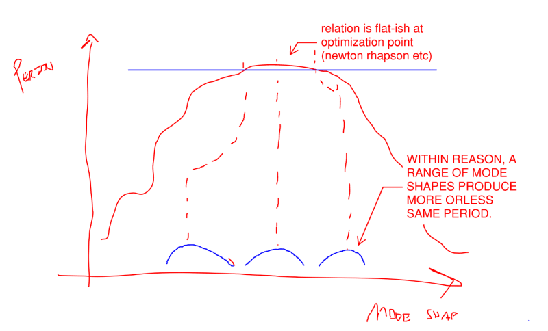

I need to hit up the library myself so I can figure out what KootK is talking about here. "the solution algorithm tends to be fairly insensitive to whether or not particularly accurate mode shapes are used / developed" right, uhhhh... *nods and smiles*
Smart ass. I'm afraid that there's just no way to dig deep on this without wading into the theoretical. It's basically this, with the sketch below added in the hope that it makes the explanation more palatable.
KootK said:
At the extrema, the curves being minimized / maximized tend to flatten for a stretch.
If you look into the derivation of RR, it's an optimization problem where you're mathematically seeking the extrema which tend to be locations where stuff isn't changing so fast. I have no idea what a Period Vs Mode Shape graph really looks like but, at the same time, I don't think that it matters much as far as this explanation goes. So the method derives its power from the fact that you don't have to nail the mode shape bang on. At the same time, however, you do need be somewhat in the ballpark. The trouble, with respect to this conversation, is somehow figuring out where the fence is at.
