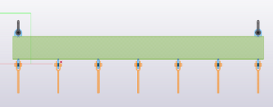

I am designing a 12.25ft lifting beam that is picked up by lifting lugs on the top flange of the beam. The lifting lugs are welded at the ends, being 12ft (144") apart, which I believe means the unbraced length would be 144"? The load is picked up by lifting lugs on the bottom of the beam spaced uniformly apart.
I am trying to size the beam in bending. Using ASME BTH-1: 3-2.3.1 Major Axis Bending of Compact Sections, I am running into a problem with the unbraced length.
I am finding that I do not have a reasonable beam size that is less then Lp (3-7) or Lr (3-10).
Using a W10x33:
Lp = 1.76 x 1.937" x sqrt(29000ksi / 50 ksi)
= 82"
Lr = sqrt(3.19 x 2.136^2 in^2 x 29000ksi x 1 / 50ksi)
[When the bending moment at any point within an unbraced length is larger than that at both end of this length, Cb shall be taken as unity. Therefore, Cb = 1.0]
= 92"
Lu = 144"?
If I am correct with Lu being the space between supports what is my next step? I wouldn't have Lu < Lr, so I believe I am stuck going to an even larger beam size? The bending stress in this situation wouldn't govern.

For your case , Effective length should be LE = 1.2LLT + 2D= 144+2*10= 164 in. ( BS 5950)
Notice that , top and bottom flanges free to rotate on plan.

So this would be saying that a W12x106 fails if that is required, which already is a beam size that isn't feasible. For a beam supported on only a 12ft span the bending capacity of this option is grossly overdesigned.
Use an HSS. HSS are typical for below the hook lifting devices since they cannot buckle laterally (LTB is a prickly thing when there is 0 lateral support, hence the onerous requirements of BTH).
If the plates don't line up from loading to support do you need to worry about wall failure using HSS? Simple solution, appreciate the response, just thinking ahead to my next concern?
The obvious question for me is why not move the lifting lugs 2'-0" inward at each end. Not only do you decrease the unsupported length from 12' to 8', but the maximum moment is reduced by a factor of about 3. With a uniform load over the full length of beam, the negative moment at each lug is w*2^2/2 = 2w. The positive moment is w*8^2/8 - 2w = 6w. With a 12' span, the positive moment is w*12^2/8 = 18w, three times as much. A W10x33 should work with capacity to spare.
Using this revised lifting arrangement I am still getting an issue with the unbraced length posed for the initial problem, Lu > Lr:
Lu = 8'x12"
= 96"
Lr = sqrt[3.19 x (2.14^2)in^2 x 29000ksi x 1 / 50ksi]
= "91.5
Cb = 1 (unity)
rt = 2.14 in^2 (compression flange + 1/3 compression web area)
Due to this I believe the design would need to be increased from a W10x33, even though capacity already is sufficient?

Your calculation does not agree with the CISC handbook for laterally unsupported members. You are from Canada, right?
So Mr for a W10x33 is 178 kN-m and Lu = 3160mm, which is 124" assuming G40.21 steel with a yield of 350 kN-m.
At 2500mm, A W10x33 is good for the full Mr, so your calculation appears conservative by comparison.
You seem to be deriving your expression from the ASCE standard with which I am not familiar, but it appears to be ultra conservative.
In any case, it appears to me that you cannot rely on a vertical pickup, because the load could be remote from the monorails.
