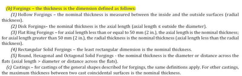

Dear All
For my project client mentions that all forgings shall be UT tested in accordance with SA388 as specified in ASME Sec VIII div 2,part 3. In our Vessel which will will be U stamped we have a WNRF Flange of Dia 8". My question is when sec VIII refer nominal thickness of different hollow forgings, what would be the nominal thickness of my flange , is it the hub thickness tF
