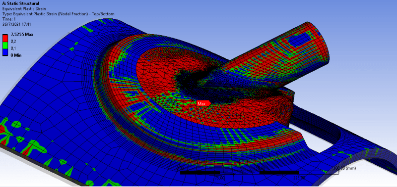

this is the model:
this is the nodal fraction (ansys plot) that measures the percentage difference between the values of strain in a node coming from it´s adjacent elements (nearest gauss point in ansys):
as you can see, there is more than 20% difference in a lot of places.
I do not think that you are showing what you think that you are showing.

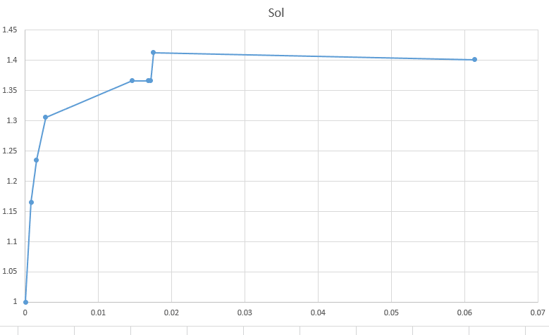

i have that too:
X axis is 1/volume of elements , and de y axis is de strain normalized being 1 the value of the coarser mesh.
however i showed the other plot since it is "more alarming" than this one.
This last post seems to be typical h-element convergence. I see nothing concerning here.
i know, but what about the nodal fraction? shouldn´t one expect a smoother transition between elements?
I am not familiar with "nodal fraction". Perhaps you should post this inquiry in the ANSYS forum for further discussion.
