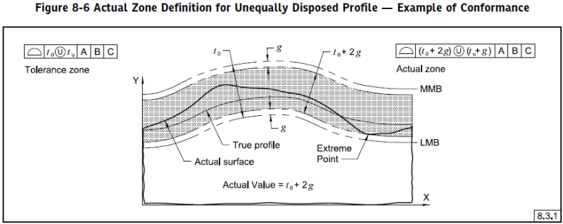

I believe ASME Y14.5.1M 2019 changed profile measurement value to be double the worst as 1994 was deviation in min/max.
My question was in 1994 did this same min/max approach apply to location or was this double the worst?
The method B data for profile directly tells users if the actual feature conforms to the drawing specification or not. That's the main purpose of it and in many cases it's all that people care about (especially when the feature is conforming).

From the draft - "Method C surface deviations for profile of a surface tolerances are gathered for the measured feature. The surface deviation values are used to determine the measured profile value for the feature..."
The explanation seems to leave no room for what Method C is for. "the measured profile value" is a singular value, not one of the two critical values. Nor does 9.3 which clearly states that 9.3.1 and 9.3.2 define Method B and Method C reporting.
The "unless otherwise specified" applies to whether surface deviation is included or not, not whether the calculation is performed - that calculation appears not to be optional. Neither does the requirement to report X,Y,Z as a comment which seems really unhelpful on rotationally enveloping surfaces.
So, a calculation that is meaningless is required; reporting the actual deviation isn't, and pass/fail is allowed, but not depicted - all in a manner that promotes using a CMM.

3DDave said:
Total runout is a one-sided limit. That reported value represents the full range of the controlled variation.
Profile is a two-sided limit. The reported value can over-report the full range of the controlled variation and doesn't report with respect to each limit.
While I agree the reported method B value can over-report the actual variation, the idea behind the method B data is explicitly explained in para. 4.5.2:
"[...] The method B reported value is the particular measured value, or a value calculated based on a measured value, that is used to determine conformance to the tolerance specification."
That's its main purpose and from that perspective the over-reporting makes no harm, because it shall never show a non-conformance where there isn't any.

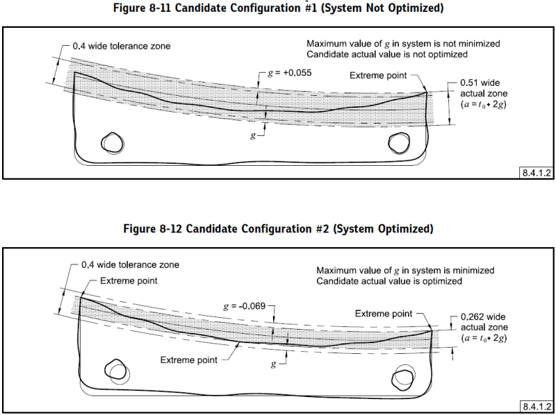

Still unanswered - and the core of the question - what engineering decision is driven by that fictitiously derived value? If you have experience with engineering teams in different companies, surely it has come up. It would definitely have come up for inclusion as the core method in the math standard and that evidence should also exist for Y14.45.
Calculating "g" allows knowing if the value is acceptable. Acceptance and rejection is simply evaluating "<=" or ">", no T+2g math required.
All I need to shut up an accept this is an engineering calculation where a one-sided evaluation of a two-sided tolerance zone makes sense.
True, however this would not allow for the direct quantitative comparison to the drawing specification, which, again, in many cases is the first and only information really needed.

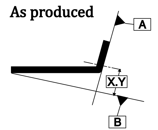

By way of example - a rectangular prism has 12 edges. Each edge is represented by a nominal 90 degree angle. Does inspection ever just go off and add 12 lines for those face pairs to the report because engineering might want to know the angularity between all face pairs?
Still - it would be a separate requirement from the profile to trace where the request for information came from. If it's not on the drawing inspection needs to justify the cost of performing the flatness check and reporting the flatness result so it would be a separate sequence number.
I was making clear that if there are people reporting basic dimension variation then Y14.5 is losing the fight and those won't be people paying to get a copy of Y14.45. For them Y14.45 is a checkbox on the CMM software and they will figure out some way to get the values from the CMM onto a page.
I have previously contrasted Y14.5 with programming languages, with the difficulty for Y14.5 being that there aren't compilers or interpreters widely available for Y14.5. Instead it ends up just as bad as if anyone were to try to learn to programming by talking to other students about what a computer might do and believing their program they wrote by hand would work as they expect it to without error. It doesn't matter how much individuals are expected to "study" Y14.5. Once they get it wrong they will tend to remain wrong. This makes the scattershot overused condition where training materials. particularly in the standards, showing easy special cases a real problem.
How tough is "Basic dimensions have no variation so no variation can be reported for basic dimensions. If you feel otherwise, tell your employer you have both made a terrible mistake in your hiring." Put that in the footer of every page.
I think the failure in the Y14.5 standard is from using the document as a cheering section, avoiding showing applications where the acceptable result is far from the naive expectation - I failed several times to convince coworkers that for mounting holes the face they were drilled into was sometimes a poor choice for the primary datum reference. The worst was a formed flange - if the flange was bent to an outside face angle that was slightly less than 90 (as springback was likely to do) then the resulting position of the hole with respect to the nominally parallel face would be unwanted.
where the flange had a +/- 1 degree tolerance (though angularity would be as relaxed similarly) with this variation exaggerated in the diagram. The horizontal portion was about 30 inches wide - 0.017 * 30 inches > 0.5 inches vertical displacement vs. the dia 0.030 position tolerance.
The argument would be that the inspectors would use a height gauge from datum feature B to check the basic location and that it was important to have datum feature A as primary to make sure the hole was perpendicular to that face. In the 0.030 sheet that would be (0.017*0.030 = 0.0005 inch lack of perpendicularity for datum feature B as primary.
Does any standard show this potential pathological case, a very common problem, and indicate why it's bad? Of course not - it's a perfectly valid callout to have A primary and B secondary. It's used all over the standards for position tolerance. The standard writers are cheerleaders who will not show their favorite tool being misused in any way.
