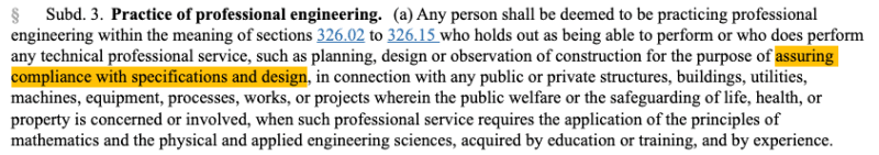

One question that still lingers in my head is in the following sentence
according to you guys what would be your interpretation of word compliance? I thought its like confirming something to internal prints of the company (maybe coz of my quality assurance background). Attorney thought it means Compliance to the LAW or in terms of Law (maybe coz of his law background) what you guys think/know? I see this standard statement in almost all the PE acts around every state.
I really appreciate all your responses and willingness to help. I got lots of valuable information and guidance from you guys than anywhere out on the internet, so THANK YOU...
In the structural world, we have "Special Inspections" for certain types of buildings. This is a building code requirement that a set of inspections above and beyond (though often similar to) local code official inspections. They have to be carried out by an approved entity, which typically means an engineering firm, and ultimately signed off by a PE. So it's not so much compliance with the law - a design may exceed the minimum requirements of the building code (the law) - but assuring compliance with it remains the purview of a PE.
I suspect that as long as you're not 'assuring compliance with specifications and design" developed by a PE, you're okay. In other words, if you advise a plant on a new management process and then observe them and give a report on whether or not they complied with your designed process, you should be okay because that process didn't require a professional engineer to create it.
