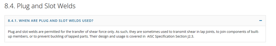

As Smoulder mentioned, in order for this approach to be realistic the member must be stiff enough to justify the stress distribution. For large values of L this method may be inaccurate.
If the orientation / magnitudes of your loads are such that the resultant places some of the plugs in tension, then I would say that this is all for not since you're generally not allowed to utilize plug welds for such applications (link).
However, if your plugs are large enough you can treat the welds as a circular fillet around the hole. That is a-okay as far as combined shear / tension (link).
