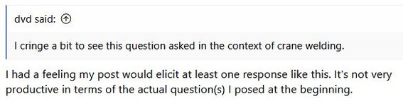

I cringe a bit to see this question asked in the context of crane welding.
I had a feeling my post would elicit at least one response like this. It's not very productive in terms of the actual question(s) I posed at the beginning.

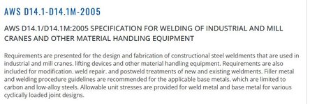

Blodgett is using AISC's 1963 Specification which had allowable stresses of 13,600 psi for E60 and 15,800 for E70. The 1969 Specification increased the allowable stresses to 18,000 psi for E60 and 21,000 psi for E70. These match the allowable stresses still used today.
E60 Allowable Stress = 0.6*Fexx/Ω = 0.6*(60,000 psi)/2 = 18,000 psi
E70 Allowable Stress = 0.6*Fexx/Ω = 0.6*(70,000 psi)/2 = 21,000 psi

But note even something like IdeaStatica doesn't do a pure stress analysis - it extracts the forces to perform the calculations based on applicable standards (AISC 360 or EN 1993), but it adds a plastic strain check (I think limiting it to 5%).
Was the suggestion to seek out a crane manufacturer's standard also not productive? Too much of a distraction from your chosen tasks?
