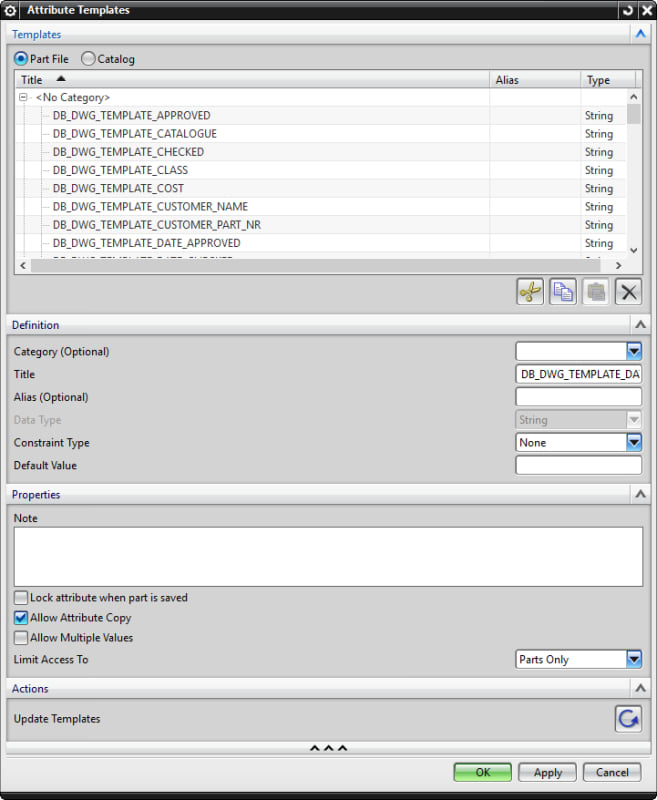

In the Template Files you need to create using the Attribute Templates utility all the Attributes with a prefix:
DB_DWG_TEMPLATE_
Then all the fields in the Title block have to be made with these Attributes

I have uploaded my Template, so you can see how I have done it.
Like I stated before,
File->Utilities->Attribute Templates
You create in the Part File Templates, all Attributes you need in the Title Block to be used.
This with a prefix DB_DWG_TEMPLATE_.....
All have to be of Data Type String.
In the Title Block, you define all the Cells with the DB_DWG_ATTRIBUTE_..... you want there.

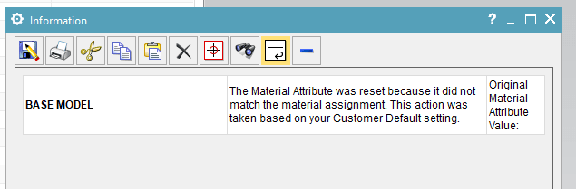

I've done the steps you mention. Ik get the following message
anny suggestions?

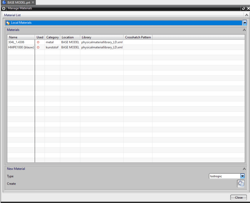

Can You provide some model to test? Maybe some move, what You do step by step. I have those messages IN NX 11, and they are very annoying. When You have some material assigned and link another body with different material, NX add it also to part. Try to look at Tools -> materials -> manage materials -> local materials and look if You have something there. If so, try to delete them. I use BOM to assign material to part.

The BASE MODEL gives the error mentioned previously.

Try to delete this 2 materials from file:
