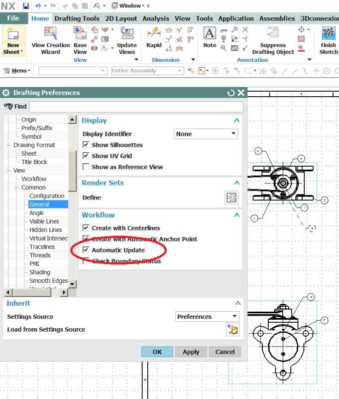

Hi all
how can i give auto update for drafting. suppose if i edit length in model i don't like to hit update in drafting to make changes how can i do auto update?
Preferences -> Drafting -> View (tab) -> uncheck Delay View Update

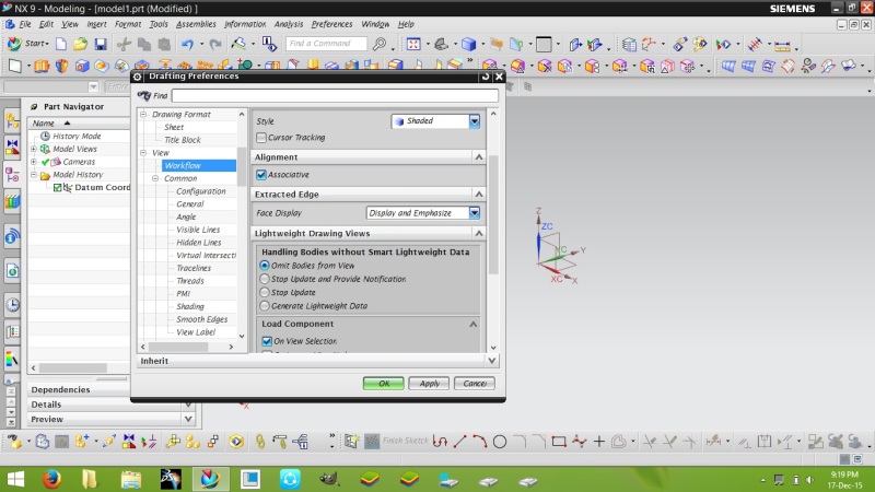

Hi jerry1423
i couldn't find Delay View Update its NX9
I am sorry, we are running different versions
In your Command Finder enter Delay View Update, and it should guide you where to go
The Command Finder should be located under your Help someplace
You're not quite at the right place (see below):
BTW, you really should be using the Ribbon interface. After all, starting with NX 11.0, that's the only option that you'll have so you might as well start to get used to it now [thumbsup2]

Hi JohnRBaker
That automatic update wont solve my problem any way i found it many thanks to jerry1423
here it is
tools/update/delay view update
