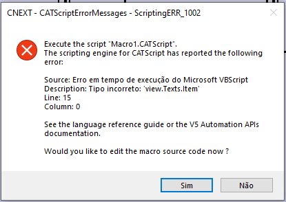

Sorry It's in portuguese, but it basically says Error in compilation, End of instruction missing
Code:
Option Explicit
Sub CATMain()
Dim doc as DrawingDocument
set doc = CATIA.ActiveDocument
Dim view as DrawingView
set view = doc.Sheets.ActiveSheet.Views.Item(2) ' 1 - background view, 2 - main view
Dim txt as DrawingText
Set txt = view.Texts.Item("Text_01")
txt.Text = "My new text"
End Sub
I've tested with CATScript too and it puts out another error :
It says Incorrect type : 'view.Texts.Item'
Here's a sample of my code for changing titleblock text boxes (in sheet background). This is used on a userform so some strings refer to clickable buttons or text boxes there.
Code:
Dim DrawingDoc As DrawingDocument
Set DrawingDoc = CATIA.ActiveDocument
Dim TitleBlockTexts As DrawingTexts
Set TitleBlockTexts = DrawingDoc.sheets.ActiveSheet.views.Item("Background View").Texts
Dim Weight
Set Weight = TitleBlockTexts.GetItem("TitleBlock_Text_Estimated_Weight")
[COLOR=#73D216]'.... code for other unrelated functions[/color]
If WeightApplyAll.Value = False Then [COLOR=#73D216]'disregard the If...Then I have an "apply to all sheets" toggle button on my userform[/color]
Weight.Text = UCase(Title_Block.Weight_TB.Value) & " " & LCase(Weight_Unit_LBL)  [COLOR=#73D216]'"Weight_Unit_LBL" is for a kg/g option on my userform[/color]
End If
yupp, GetItem does the trick! thx
