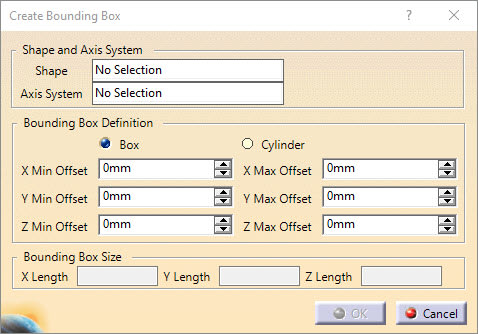

I am creating an optimized bounding box depending on what inputs you have.

jzecha, there is an OOB bounding-box function in Core-Cavity Workbench (shareable CCV)
regards,
LWolf

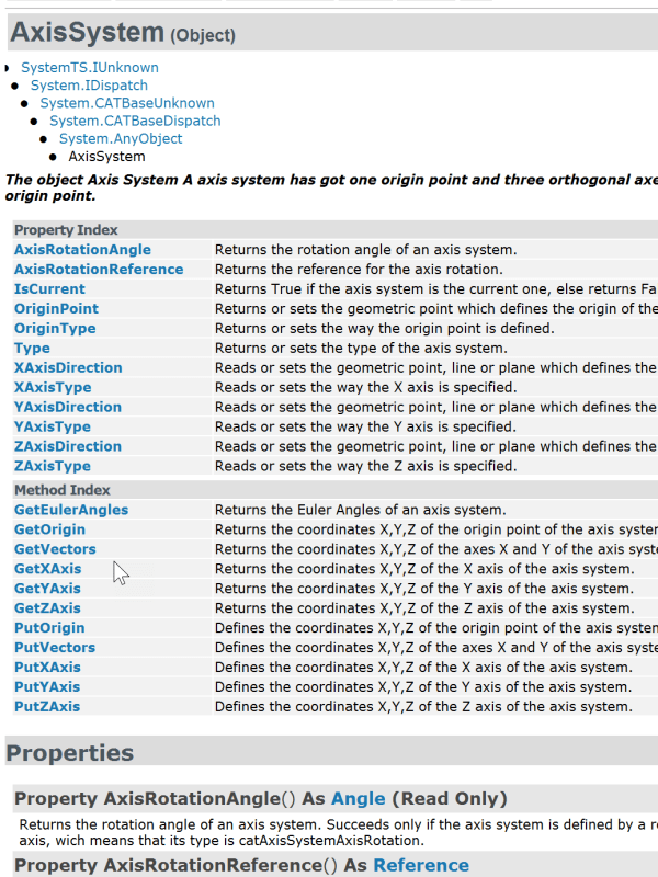

looking at the chm file i find that AxisSystem do have GetYAxis Method.. could that help?
Eric N.
That worked @itsmyjob, but I was hoping to find some way of referencing the Axis leg itself instead of creating coordinates.
Either way, thanks for the help in pointing me in the right direction.
