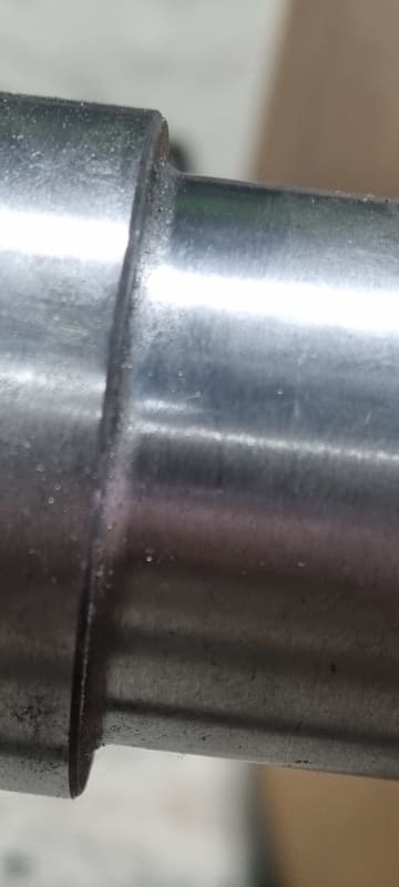

Hi, I'd like to get the groups thoughts on why this axle shaft failed and how to best go about testing the rest of them. The shaft is heat treated 4140, from machining the splines the hardness seems to be the outer 2-3mm.
Unfortunately I don't have much information from the manufacturer to go with
The vehicle is reasonably heavy but low powered and was travelling at speed when this happened
Thanks in advance for any help

Looks like a fatigue fracture that looks to have originated at a stress concentration where the shaft diameter changed abruptly. Usually I would look at the way the wheel/axle was loaded, but that's not presented.
Given how little material remained at the final stage as seen by the small circle in the middle, the material seems sufficiently strong. Maybe it was overloaded some time to bend the axle or maybe it's been running overloaded for a long time, or maybe the radius at the change in diameter is just too small.

It broke right where the radius of the inner bearing race met the shaft the shaft appears to have been of a straight diameter at that point. There is a step in diameters where the shaft appears to have butted against the eating but I don't see anything to indicate that the failure initiated at that step. It's possible that the shaft wasn't properly seated against the bearing which led to a fatigue failure.
Our thoughts were the radius between the step up is insufficient. But we dismissed that as its almost exactly the same as the different brand replacement
The failure does not appear to have initiated in the radius on the shaft. It appears to have initiated at the point of contact between the bearing race and shaft. If the shaft were property seated against the bearing race there should be no bending where the shaft failed. I don't think the shaft was seated properly against the bearing race. This may have been an improper assembly and there was no defect in the part.

The fracture in the bearing side appears to be at the same depth as the chamfer that is there to clear the radius. I expect it was fully seated.
As long as there is a chamfer there will be bending where the chamfer ends. Perhaps easing the edge of the chamfer would help. It's still a very short stub of that small diameter so the difference in bending is small.

the fractured surface exhibits many concentric circles coupled with a "fiber" small circle at the center. In addition, there is no obvious fracture origin. This all suggests it is a rotational fatigue fracture under high stress conditions along the end edge of shaft. The smaller radius could introduce significant stress to reduce a fatigue life.
The failure point where the shaft diameter has stepped down is typical and expected in shaft failures, especially fatigue. This is the point where stress is highest, and not in the corner itself. Visually it looks like fatigue with multiple ratchet marks at5 the OD indicating multiple origins. Again not surprising. First thing you should do is characterize the fracture surface in an SEM to determine likely failure mode. You should be able to confirm dimple ductile rupture from overload (as it looks) in the center.
The high surface hardness, possibly caused by surface hardening techniques like quenching or induction heating, may result in a relatively softer core. A large hardness gradient can lead to brittle fracture under high-stress conditions. This is especially true when the component is subjected to heavy loads or strong impacts, as the hard and brittle surface is more likely to develop cracks that can propagate throughout the shaft.

I'm still unclear whether the fracture surface propagated from a groove machined in the shaft.
Any micromotion of the shaft within the bearing at the edge near the shaft shoulder would cause fretting. The endurance strength of a fretted surface is mighty low.
I think the bearing would need to be clamped HARD against the shaft shoulder in order to take over as part of the bending load path.
Is the picture of an un-broken shaft the new replacement shaft?
Is the mottled gray surface from shot-peening ? That could provide be a BIG improvement.
The radius/fillet profile on the lower side of the shaft looks uneven.
A uniform, well blended radius is required.
