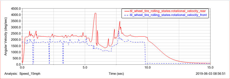

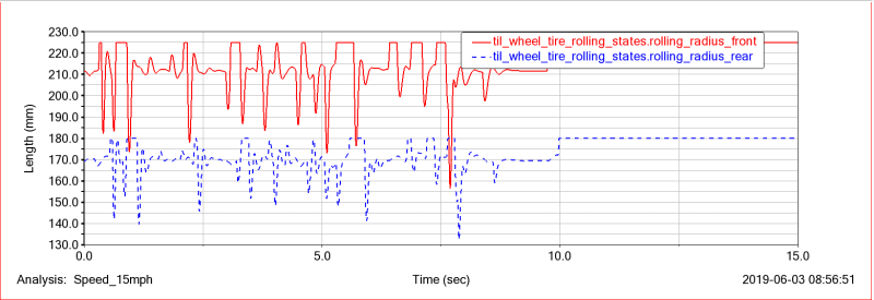

I've got a post-made model that is for year 2009 and it has different results than what is given with its accompanying video
the wonder is where the Numeric Value in postprocessing is the same as the video and given results by the MSC model but the units are different
what can i do ???? please help
the model is at the following address
and i have uploaded results pictures: the right ones are my results but the left ones are the video from 2009

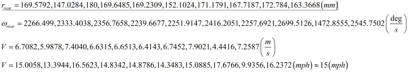

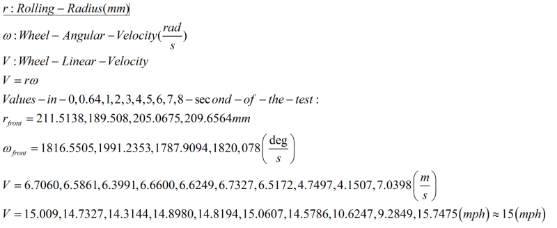

Is it possible that the file driven event is giving the results for the intended unit in 2009 ( g or kph ) and the Adams 2018 is just showing the wrong unit ???
just a theory ... i say this because the numbers and the peaks are almost exactly the same ...

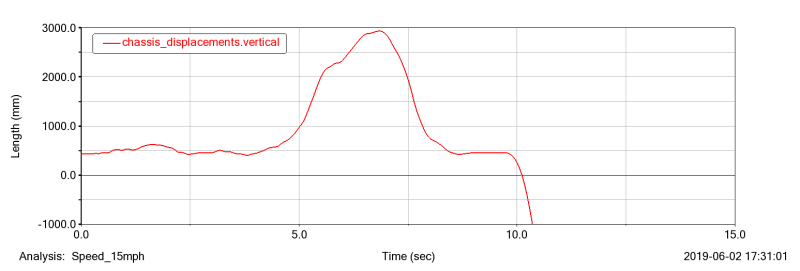

yes you are right sorry I checked that and it gave this :

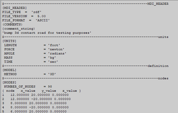

when i said it is a file driven event . i ment it has a Road Data File and a Driver Control Files as every file driven event does , and the Road Data File Info is as following :
in this Info , the units are foot , newton , radians , kg and sec , and i'm choosing MMKS units when i run the simulation , is it possible that the results are showing me the units of the default road file with the herald of MMKS ?? what i mean is that is it possible that the results that are being shown are based on the units given by the road file ???

I did what you said and I saw that eventhough my predefined unit in adams and postprocessing was MMKS , only those two graghs that I mentioned earlier , had a different unit and were kph=(kilometers per hour ) and based on g ( gravitation ) … so the units on those two graphs were defined different than the other graphs ( exclamation point )
so there was the reason for my confusion ... and that's why i made him a little upset ...
however ... thanks a lot you , solved my problem ...
