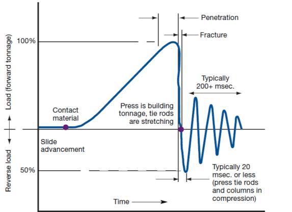

But there's another crankshaft-and-slider mechanism that I commonly deal with, which most certainly does NOT use crank counterweights or make any attempt to balance the reciprocating mass at all. Mechanical stamping presses.
They shake the floor. The big ones shake the whole building and you can feel them outside. Better not have close neighbors that rely on you being quiet.
I think most of the stamping press shock is from snap-through, when the punch overcomes the material resistance and fractures the material.
