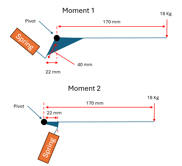

Hi everyone, I'm creating a mechanism to lift a weight and I need to make sure I'm calculating correctly in order to design the correct spring. The first image below shows you my current design, but I have realized that there is a lever action here that could drastically increase the force on my spring. In the moment diagrams I have outlined how I think I can mitigate the lever action by bringing. What I would like is for someone to correct my maths and basically show me what the force on the spring really is. Thanks
Current setup:
Force on spring: 18 x 9.81 x (0.170/0.040) = 750 N's
Potential Setup:
Force on spring: 18 x 9.81 x (0.17-0.022) = 26 N's

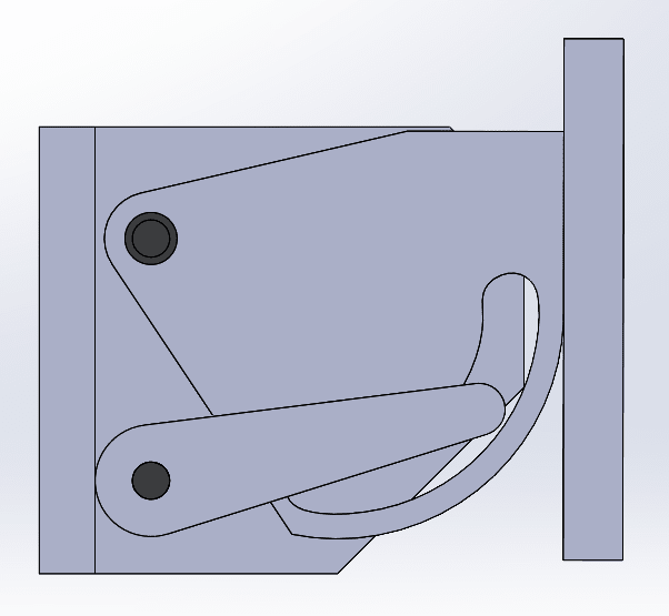

You need to account for the roller in the slot; the force can only be tangent to the slot edge.
The Slot/CAM profile is needed to balance the spring compression at different angles - giving more or less force as required to give a counter balancing effect no matter the angle. Where do you see the issues here? please be specific. Also do you see anything wrong with the maths? See below CAD of the potential new setup. Any of these mechanism can work using a a torque spring instead of a compression spring

Ah ok I can see I did a bad job of explaining my issue. The CAM and Spring in this design are easily designed to give a counterbalance effect. What I' more concerned about is calculating the correct force is on the spring if we just look at static horizontal position. So I was looking to find out if there is a lever action from the first moment because the spring is behind the pivot point and therefore the is a lever effect on the spring creating a 45mm/170mm ratio which amphiphiles the force on the spring by approx 4X. In moment 2 the spring is directly connected to the arm in front of the pivot point so there is no lever action, just a weight at a 148mm distance from the spring. The force for this moment is drastically lower based on my calc's, 26 N's as opposed to 750 N's. My questions is, are these assumptions correct when I'm just considering potential force on a spring from the weigh in a horizontal position? Thanks

Please ignore "counterbalancing effect no matter the angle". I am looking to find what force is needed by the spring to keep these two weights horizontal to the pivot point. Thank you
given those sketches, if you set sum(moments) = 0, for
case #1, the spring force =~ 18 * (170 / 40)
case #2, the spring force is =~ 18 * (170 / 22)
Case 1: About 750 N.
Case 2: About 1360 N.
Not enough information to be more precise.
