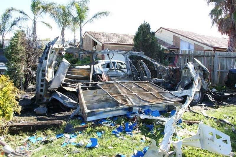

Acetylene cylinders aren't supposed to be stored in confined spaces as the "Lower Explosive or Flammable Limit" is just 2.5% (% by volume of air). Where I worked, the unskilled staff kept cylinders in the back of a transit van and one of the vans exploded while being driven.
This image shows what happens when acetylene cylinders are housed in a enclosed van. The electric clock in the vehicle is enough to ignite the acetylene.
There a number of safety bulletins on this.
