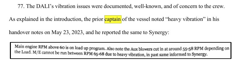

Paragraph 5, logs? from a prior captain "heavy vibration" were breaking stuff
... "it should have come as no surprise when circuit breakers to the transformer tripped due to loose and damaged circuitry."
and it gets worse in Paragraph 6,
... "this automation, a safety feature ..., had been recklessly disabled."
Further reading of DOJ Complaint leads to the conclusion that excessive vibration was caused by transformer 1, and not the engine. No mention of vibrations affecting transformer 2.

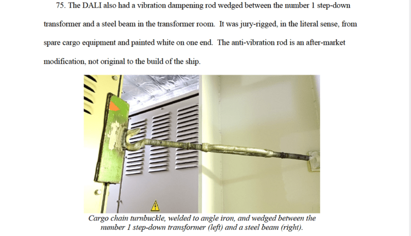

Gotta Love this Custom Off the Floor 'Anti-Vibration' Dampening Rod......
EDIT: This excerpt indicates overall vibrations from engine, but for some reason transformer 1 affected more than 2, or transformer 1 itself had internal vibration issues, or perhaps transformer 1 had more hours of use or exposure to vibrations?
"4. The DALI’s number 1 step-down transformer is a large electrical device that converts high-voltage power produced by the ship’s diesel generators into lower 440-volt power. This transformer and its circuity and breakers had long suffered the effects of heavy vibrations, a well-known cause of transformer and electrical failure. Instead of taking steps to eliminate the source of excessive vibrations, Petitioners jury-rigged their ship. They retrofitted the transformer with anti-vibration braces, one of which had cracked over time, had been repaired with welds, and had cracked again. And they also wedged a metal cargo hook between the transformer and a nearby steel beam, in a makeshift attempt to limit vibration."
"5. These telltale signs of vibration problems were not isolated. The ship’s previous chief officer reported that “constant vibrations” above the engine room were shaking loose the ship’s cargo lashings. Engineers noted that these problems were cracking equipment in the engine room. A prior captain wrote that “heavy vibration” at certain speeds had been reported to Synergy, the technical manager of the vessel. Accordingly, it should have come as no surprise when the circuit breakers to the transformer tripped due to loose and damaged circuitry."

The following statement leads me to believe that engine vibrations were creating a resonant condition with some of the hull structure.
Case 1:24-cv-00941-JKB Document 82 Filed 09/18/24 Page 16 of 53 said:
It is not unheard of for equipment to have forbidden operating speeds, but managing this shipboard, I can not see passing quickly through the forbidden operating zone in a ship propulsion situation.
This vibration could create cracks in the hull structure.
Slow speed diesel engines don't have counterweights. This does cause significant vibration in the ship a high speeds. Modern engines installations have an attenuator that generates destructive interference. I was a steam intern and do high speed diesel now so I can't tell you what it's called. Maybe I'll remember.
Large diesel engines and large steam turbines can have critical speeds that they should not be operated at for an extended period because of the vibration caused. When an engine has a damaging critical speed or speeds the information is displayed near the controls so the operator does not allow the engine to remain at that speed.

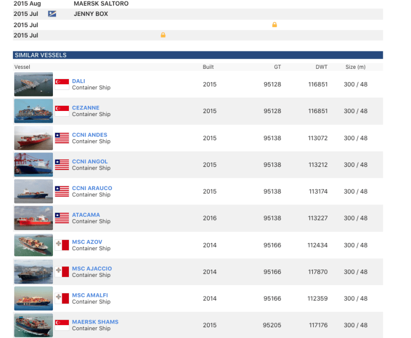

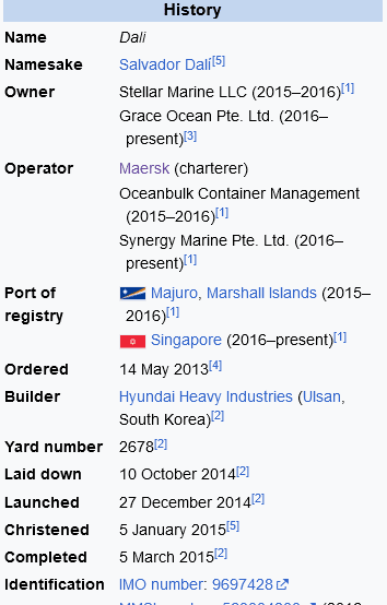

Maersk Saltoro was built in 2015 according to vesselfinder. Dali sea trials were completed Dec 2014, and Dali was delivered to customer 2-3 months later. Wonder if Court is going to evaluate this ship, and compare it's condition to the Dali? Assuming both ships are built by Hyundai and comparable?
And the answer is:
MPR NEWS said:
Like the Dali, the Singapore-flagged Saltoro was built by Hyundai in 2015.
Edit: According to vessel finder, these are the similar ships to Maersk Saltoro, with Dali being one of those. Looks like 4 of them are flying Singapore Flag.

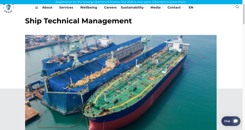

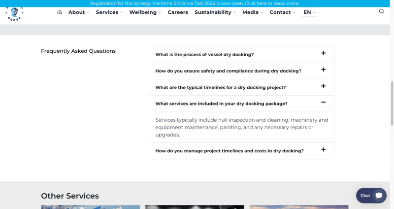

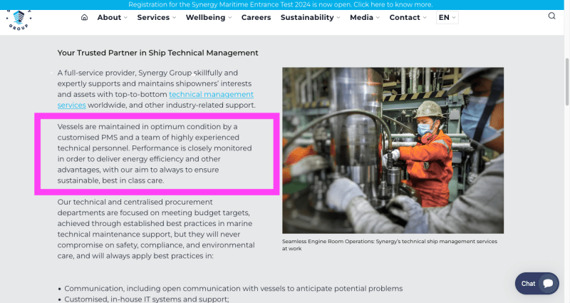

Information from Synergy Marine Group's Web Site; Dali's and Maersk Saltoro's Ship Management Company, per attached 2023 Brochure and web site link.
Synergy Group said:
A Full-Service Provider with End-to-end Maritime Solutions.....
Synergy Marine Group said:
Vessel's are maintained in optimum conditon........

My point was only showing it appears the Dali Container Ship and Maersk Saltoro were both originally completed in 2015, at the same ship yard, and have similar specifications and serial numbers. Thus perhaps sister ships.
Perhaps FBI raided Saltoro, because they had insight that it was in a bad state of maintenance or the opposite? I noticed on vessel tracker than another Singapore Flagged sister ship left the US Baltimore Port about 10 days ago? I have not seen anything about it being boarded?
Screenshot_2024-09-22_at_16-28-08_Baltimore_Bridge_collapse_after_ship_collision_-_Engineering_Failures_Disasters_-_Eng-Tips_nfklnt.png

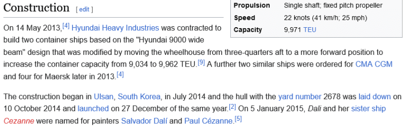

You had made the claim that the Dali was delivered, finished, and sea trials completed all in Dec. 2014. I'm glad we now agree that it was actually 2015.
You made the claim that sea trials happened in Dec 2014 so it is your responsibility to prove it, not mine. I did search when you posted that because I knew the date had to be wrong and found nothing at all except for what you said here, that's why I asked.
It appears that the first two sister ships ordered were the Cezanne, IMO 9697416 built Jan 2015, and Dali IMO9697428 built Mar 2015 are much closer to each other than the Saltoro, IMO 9725706 Aug 2015 and Dali. I would consider the Saltoro a step sister or cousin maybe.
