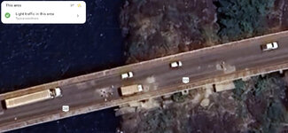

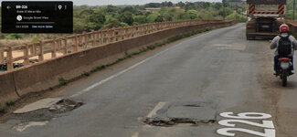

The deterioration over the east and west supports is rather astonishing. It's not as though informed persons were unaware of what was happening. Even the satellite imagery (Google Maps) captured the repair crew putting lipstick on the pig.

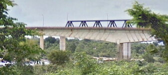

That marked-up photo above was too small.
Here it is larger, although somewhat pixelated:
Thanks for your insightful post. Where did you find the photo and what was the context. It looks like it was pre collapse with extraordinary damage to the strengthening elements. (There was more of a left over stub than I thought)
