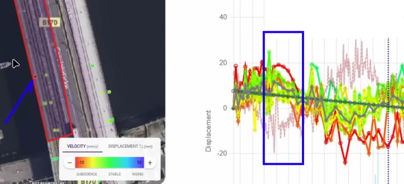

The nice thing about space based measurements is that an entire city can be measured at the same time and every measurement stored for quantitative comparison.

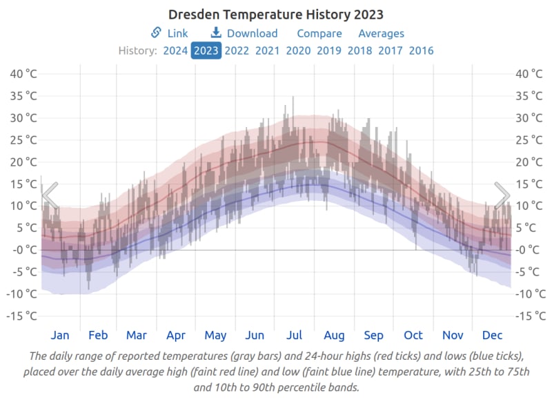

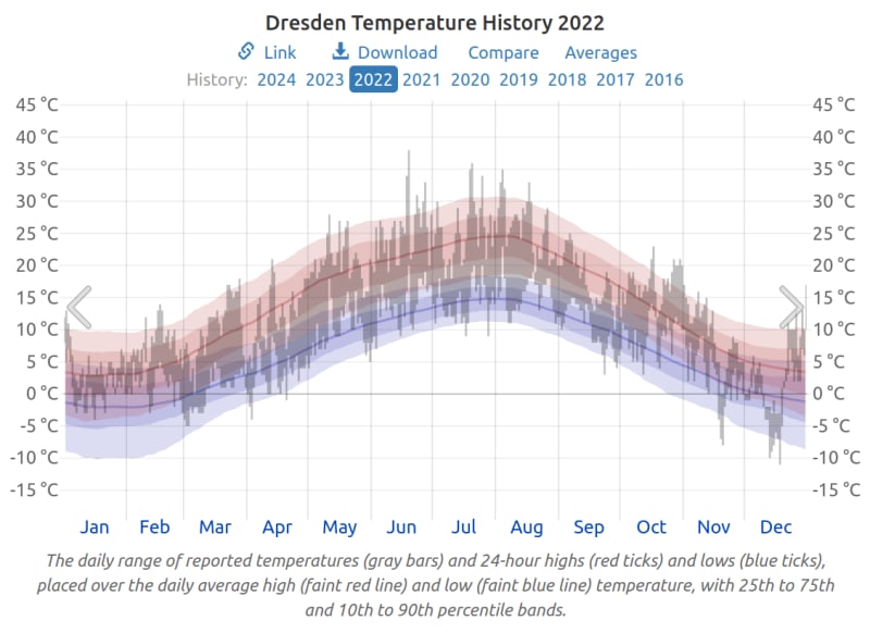

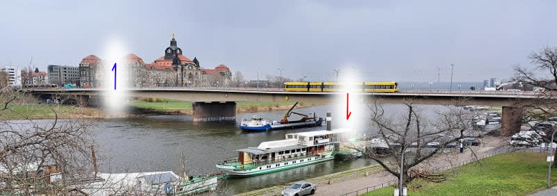

Using the information from the Casey Jones video, it appears something happened in Dec 2022 when there was a hard freeze (-11C) followed a week later by abnormal warmth (+17C). The displacement of the red line assumed an abnormal curve in the following weeks and then a steady trend of downward displacement until collapse. Maximum downward and upward displacement was recorded at approx. 60 mm just prior to collapse.
weatherspark.com

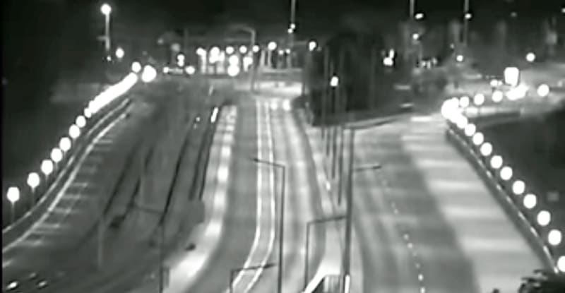

In the last video frame prior to collapse, downward deflection (left side of image) was obvious both north and south of the bridge support.

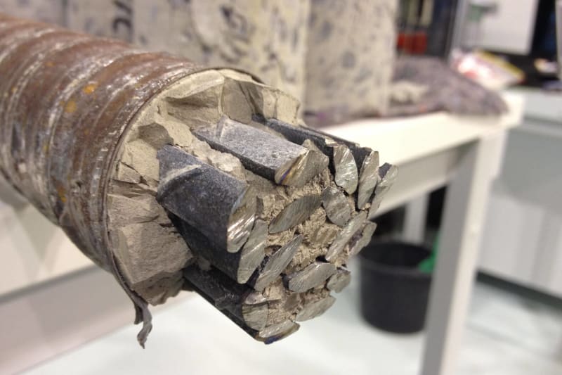

6:59. Here on this side the rod is in great shape and has no damage whatsoever. A few centimeters further on it has almost no cross-section. You can see here that this is called pitting corrosion. The rod is basically almost corroded away in one place.
That is also the dangerous thing about this form of corrosion. If you only open a small window, you can't really see it. If you open it here by accident, everything looks fine. 20 cm away it looks like this. That makes it very difficult to assess.
The material in question is Hennigsdorf prestressing steel, the western equiv. being Sigmar Oval steel. It is "very high-strength due to the tempering process."

16:21. The Otto Mohr Laboratory at the TU Dresden is one of the most modern testing laboratories for the construction industry in Germany. Dr. Silke Scheerer and her team have been researching this special metal there for years. We have already taken a lot of samples in the lab, especially from old stocks, and we took samples from demolished buildings. Simply to generate more knowledge. In most cases we had very good strength values, very good elongation values, but not in every case. In other words, it has the potential to fail on the inside, but that is not the norm. The Carola Bridge is obviously an exception. The prestressing steel, which had been damaged by corrosion, failed without warning from one moment to the next.

Whether cable or bars, the issue with this bridge was apparently corrosion. Does anyone know what was supposed to protect the reinforcement?
I'm wondering why the samples being shown appear to have inadequate grout.
Sym P. le,
Your question would assume bonded post-tensioning, with inadequate grouting. Do we know that, or was it an unbonded system, with inadequate protection?
At 9:29 it appears the sample is unbonded and the duct is so tightly packed with steel that grout fill would be difficult to guarantee. At 9:43, the sample is only partially grouted.
No further details are offered so we'll just have to wait. [frosty]
'Unbonded' typically means without grout. So if that is the case, it would have required protection by other means.
The tendons were bonded (grouted) tendons using HENNIGSDORF prestressing steel (oval-shaped tensioned wires) that have a history of stress corrosion cracking (SCC).
Voids in the grout (to bonded tendons) is still a problem today unless specially formulated grout and vacuum-assisted grouting techniques are used.
