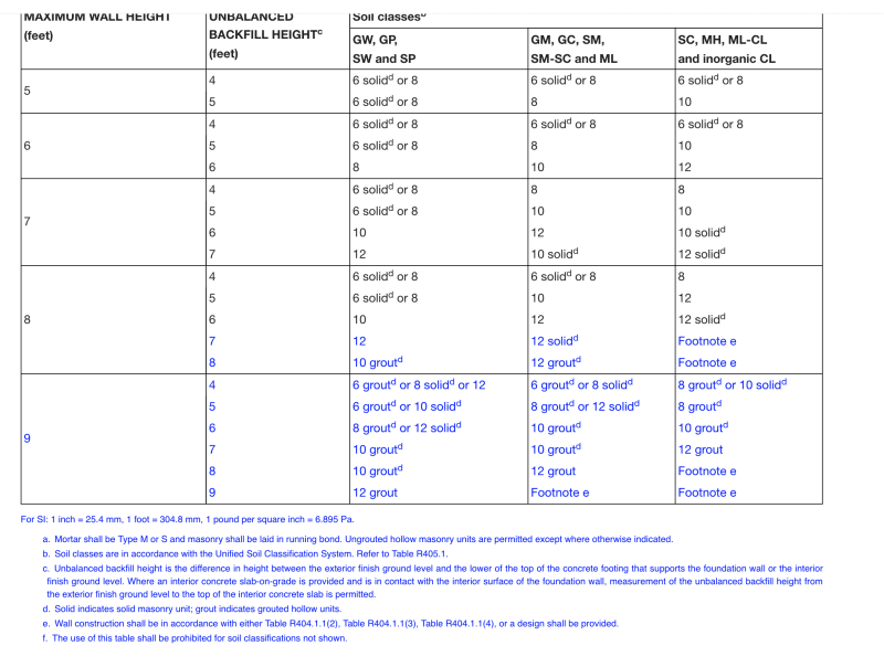

XR250:
Would you mind pointing me to the code section that indicates the slab on grade braces the wall, I don't recall every seeing this in IRC or IBC and would be nice to have for future backup.
See footnote C. I assume if they are measuring the backfill height from the top of the slab, they are using the slab as a bracing point.
Would you consider the slab on grade in OP's detail as being in contact with the wall provided there is a 1/2" isolation joint filled with compressible material. Throughout my admittedly shorter carrier I have never seen a detail showing the slab on grade in direct contact with the foundation wall.
