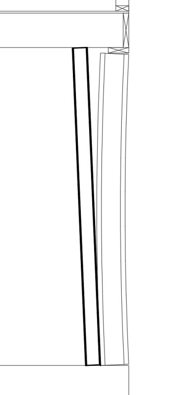

Re: my stress reversal comment. For a long basement wall that is bowing in, it is essentially behaving with one-way action spanning from base to joists (especially near the center). When you add these beams and start jacking, you'll end up with continuous two way action the wall. You'll introduce tension in the exterior face at the beams where it is trying to span continuously and where it is currently only on compression. The more you can limit the flexural deflections (or strain, and therefore limiting the stress in the masonry system itself), the less cracking you'll get.

phamENG, ok I gotcha - turning the simple span into a two-span continous via the point loading. My preliminary design idea would prevent this because I wouldn't be jacking in the middle of the beam, I would be doing it via turn of a bolt at the top of the beam (maybe bottom, too), and I wouldn't be doing it all at one time.
Here's another picture for sake of clarity.

hemiv - I disagree with your assessment that this situation would be prevented. Flip this system on its side. If I understand you correctly (which I may not, so I apologize if that's the case), it sounds like you're saying that a slab supported by a beam with a jack on one end wouldn't be lifted by the beam as you raise the jack.
You may not get a perfectly uniform load and, yes, it will be lower at the center, but it will tend toward being uniform as your column gets stiffer. Also, your reaction would be just below the center of the wall at first. Look at the attached image I just sketched up. It's to scale with a 7' CMU wall and a 1" out of plane deflection at the middle. When you first install your system, the uppermost point of contact will be just below the inflection point of the wall and it will slowly come into full contact as you tighten the bracket above.

Ah, yes, I follow you now. Tension stresses developing on the outside of the wall perpendicular to existing tension stress on the inside of the wall? The CMU wall turns into a continuous span with moment reversals at the supports? Even so, the wall is already support a moment of wl^2/8, and the reversed moments would be less than that, as "l" decreases and the denominator increases.
Your picture is basically the case, jacking at the top in small increments via a bolt. I would probably not incline the beam as you've shown; I would plumb it or split the difference, and possibly grout in front it to help distribute loads.

I wouldn't grout it unless it's a semi-compressible material. Otherwise your jacking will just translate the wall rather than remove the deflection.
And although the resulting moments will be less, the tension stresses will be higher than what it's seeing now, and I think you'll get some pretty nice cracks in your wall. Perhaps it will be less than I'm thinking - I usually go too far at first and then talk myself back with analysis.
