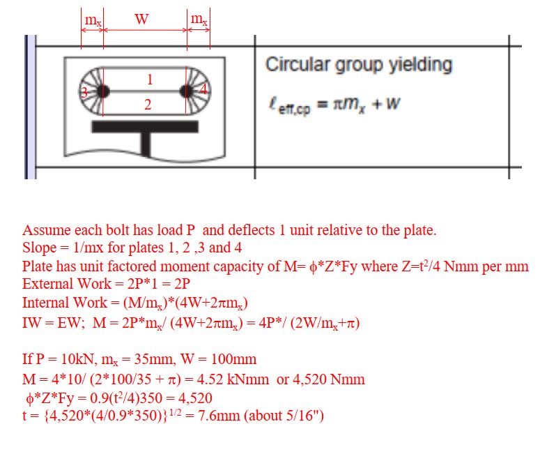

How exactly do I calculate the effective bending line on a base plate like shown below?
I've read that there are 45 degree projection lines that comes from the bolts. What about the farther bolt from the bend line? Is that one also projecting and therefore causes a larger line?
Visually I am having trouble determining how this bending line comes out to be. I've seen in another eng-tips post that also mentions including the perpendicular distance as well, so not sure about that one.
Hope someone can point me in right direction.Thanks.

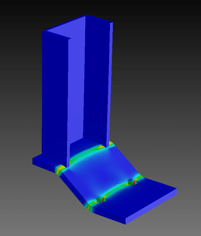

It looks like this is modelled in Hilti Profis. If you use the FEM baseplate option and increase the loads beyond yield, the output should show you where the yield lines are forming.
I got curious and followed my own suggestion. See attached for a sample Profis study. Not sure how valuable it is by itself, but perhaps useful as a check against classical hand calc methods.
I don't believe the bolt layout was wisely chosen. If this is still in the design stage, it would seem reasonable to increase the number of anchor bolts and adjust their location to something a little more sensible.
Thanks bones - I've yet to bite the bullet and buy Profis Premium, though it does seem well worth the value.
In this case, it seems the flexural restraint at the channel is not being accounted for and the plate is completely free to rotate about the bolt line, thus we're only seeing the one hinge. Not sure Profis could capture this restraint anyhow.
No, Profis could not without knowing the EI and length of the channel. That was not given and neither was dimension 'a' nor the width of the plate.
I just did a mockup with arbitrary sizes and materials for proof-of-concept demo purposes. What I think it's showing is initial yield line forming at the bolts, then progressive spread of plasticity in the base plate in the direction of the channel. I visualize this deforming in a curled shape similar to the prying action figure that Flotsam posted. It's too bad Profis does not provide a deformed shape in it's output.
I was curious what this would look like, so here is my quick and dirty FE model. This is showing the plate curvature, so it gives a nice idea of where the yield lines are forming. Nothing unexpected.
This gives a much better visual than profis, and validates BAretired’s yield line approach.
If it were me I'd still limit the plate to first yield and avoid prying in the anchors unless the results were unreasonable. This will also help limit deflection.

plus significant prying action...
I would not argue with Flotsam7018 on limiting the plate to first yield. One additional anchor bolt at the c.g of channel would seem like a good idea too.
@bkal...
is there more to that image? and what does the leff mean? This is useful information to have. What is the source? Thanks...
dik - the leff is just the effective bending width.
This AISC white paper by Bo Dowswell is a favorite of mine if you haven't come across it previously:
It goes over many different yield line solutions presented throughout the years (including some of those in bkal's reference) providing experimental results and comparison, rules of thumb for when certain yield lines would control, etc. A truly great reference.
Thanks... downloaded both articles. The leff is used to determine the plastic section modulus using leff*t^2/4? I'll take a look at the articles; I wasn't aware of them... again, thanks...
I believe that leff is the length of yield line.
Thanks BART... just confirming... value times Zx (Sx down under) gives the moment resistance. I haven't had a chance to look at the publication that shows that leff really is.

In some cases, that is true but consider the third example of Circular Patterns. The value given for leff must be considered carefully. The value listed can't be used directly for all yield line patterns.
