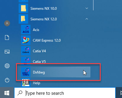

impressive piece of code, i hope that you know that there is a standalone translator , where you can select a directory as input?
And, if i remember things correctly , you can run the translators in silent mode batch. ( help me remember how to do this.)
the interactive standalone translator :

external translator
(I am not certain the version of WINDOWS that I am on)
Start (on WINDOWS) -> Siemens NX -> Translator - DXF/DWG
