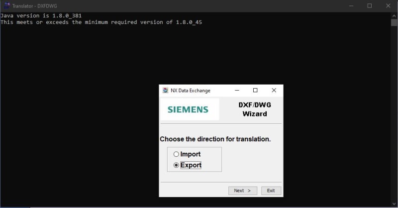

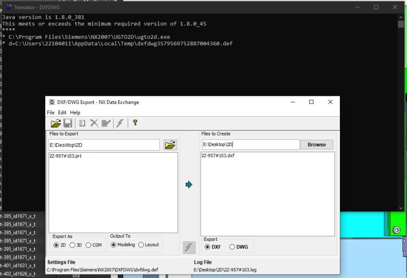

Hi everyone,
I am trying to combine the VB code from these two Journals:
My purpose is to batch export from prt to dxf/dwg files, from folder to folder.
This is what it looks like:

There is nothing created in the destination folder (E:\Desktop\2D). After choosing the input file and the destination folder, I clicked on the lightning symbol in the middle of the box, and I then received the screen as posted. I tried to wait but nothing happened then.
Additional information: At first, I did not have Java in my PC to run it, so I downloaded the latest Java version on its website and just simply installed it right then but nothing more.
Could you guide me how to use it, please?
Thank you,
Hao
This is how it looks when I open the translator. I chose Export and followed the steps mentioned above. Unlucky nothing transpired, even when I chose Import.
Dear cowski,
The answer is yes. I used those files to export to PDF then publish to my customers. I just use them as some typical samples.
However, I will try with other prt files from other projects to figure out hopefully I am wrong or not.
If the translator works properly, I will receive DXF/DWG files in the destination folder right after I click the lightning symbol?
